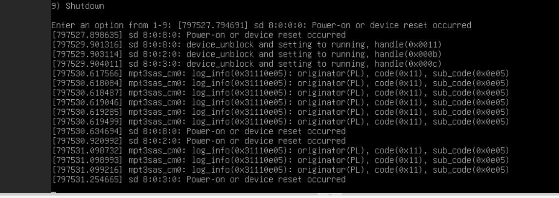

My pool is telling me that I have an unrecoverable error, however, in the SMART test I don’t see anything. What am I missing?

It’s just getting worse. I tried a scrub and one drive failed so replaced it and now lots of errors.
Actually, a lot of changes recently. I created a new VM, Proxmox, on a different server with a different HBA card moved the drives to that server and imported the pool and that worked surprisingly well and it ran for a bit without issues. And it was CORE to SCALE as well. During the scrub one HDD status became REMOVED so I replaced it but still lots of errors. I doubled the RAM on the VM when I created the new VM as well from 32GB to 64GB and it is ECC RAM and a faster more powerful server. There is another HBA card attached to that VM and that pool has been fine. Maybe it’s that HBA card.

Yes Proxmox on bare metal with 64GB of RAM on the VM set with ballon=0 so from what I understand that is dedicated physical RAM. The HBA card is passed through to the VM, as well as another one. I did do the “Upgraded the ZFS Feature Set” as I needed to do that on the other pool to extend it and that all worked fine too. I figured since it was fine there I did it on this pool tool. I have this pool replicated to the other pool and another server so worst case I can blow it all away and start over but would like to figure out if it’s the HBA card or not, I’ll keep working on it. Thanks for the help.
