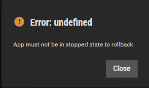

When I try to roll back I get:
The app currently is stopped but I don’t get a rollback button in the few tenths of seconds when the app is running.
