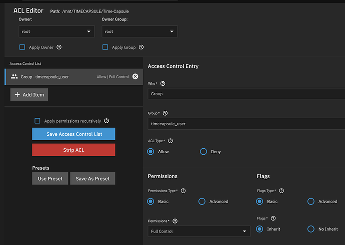

On dataset the settings are:
Owner: root
Owner Group: Share_Users
ACL entry only this:
Group - Share_User Allow / Full Control

Can you share a screenshot of the ACL from the TrueNAS UI.
Try changing the owner group back to root and recursively set permissions.
