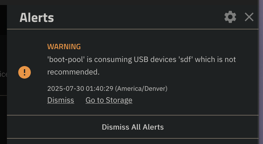

Alright, I got my system booted up, all drives recognized and everything seems to be working great. The only issue I’ve encountered is this message I get every boot. I think it’s telling me that running my boot drive in the USB enclosure is bad? Should I be concerned about this? Enclosure has plenty of ventilation.
I think that is a normal warning about USB. It’s just a single ‘drive’ attached to USB?
It’s just a low-power 128gb Gen3 NVME in an aluminum enclosure.
More just checking you didn’t have something that had two or more drives in a mirror in an enclosure.

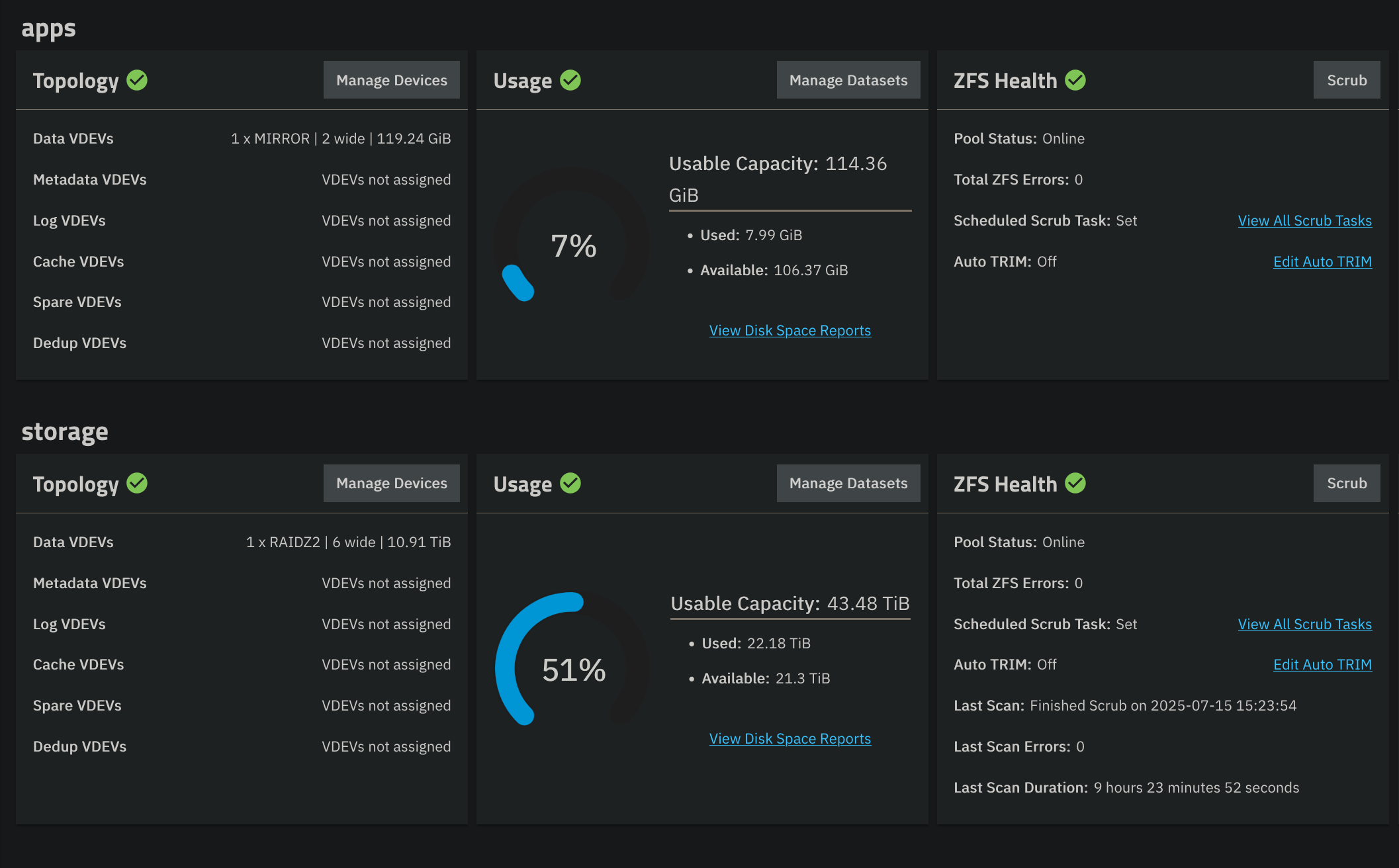

Do you have your two NVMe in a mirror pair for you apps pool now? Are you okay doing the Replace procedure for the failed one?
Yup, apps pool NVMEs are in the motherboard slots (mirrored). Boot NVME is in USB enclosure. I did end up creating the pool with the same ‘apps’ name it had previously, and had no issues (I did have to delete the previous share).
