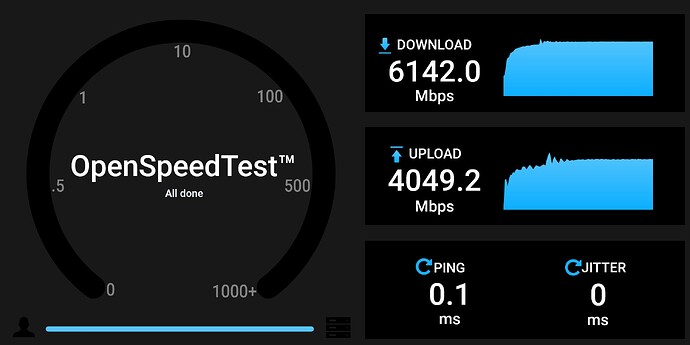

openspeedtest is hosted on the truenas using docker. For accurate results i used firefox browser to the lan ip for the openspeedtest from the S24 Ultra client device. So basically it’s testing wireless performance from the smartphone to the truenas for local network.
This is Wifi6 @ 6GHz within arms reach to the ap

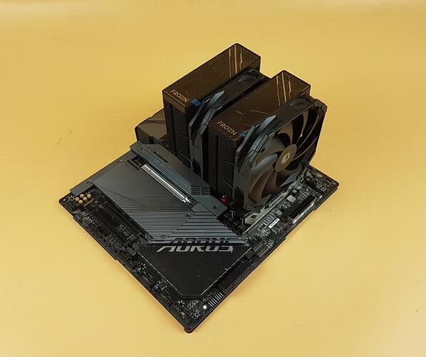

These are the parts i upgraded. Casing, PSU and the rests not mention is same cause those were fine
AMD 7800X3D
MSI MAG X870 Tomahawk Wifi (this is wifi7)
Frzn A720 Cpu Cooler
Kingston Fury Beast DDR5 cl30 6000M/T 16gb X 2 (AMD EXPO kit)
RX 7800 XT Sapphire Nitro+ (didnt upgrade graphics card, this was fine for my needs)
Fractal Torrent (best rated in 2021 for fan cooling pc case)

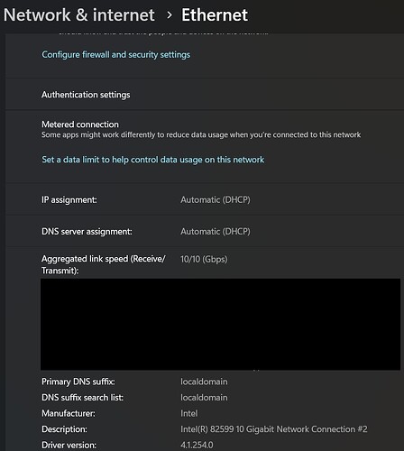

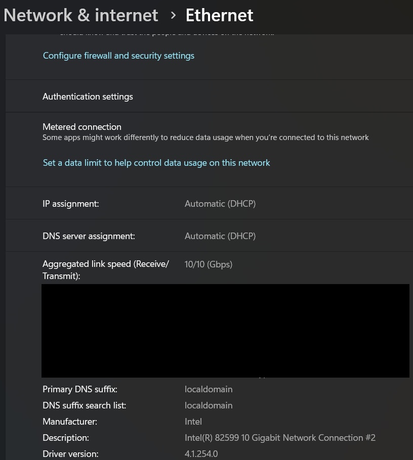

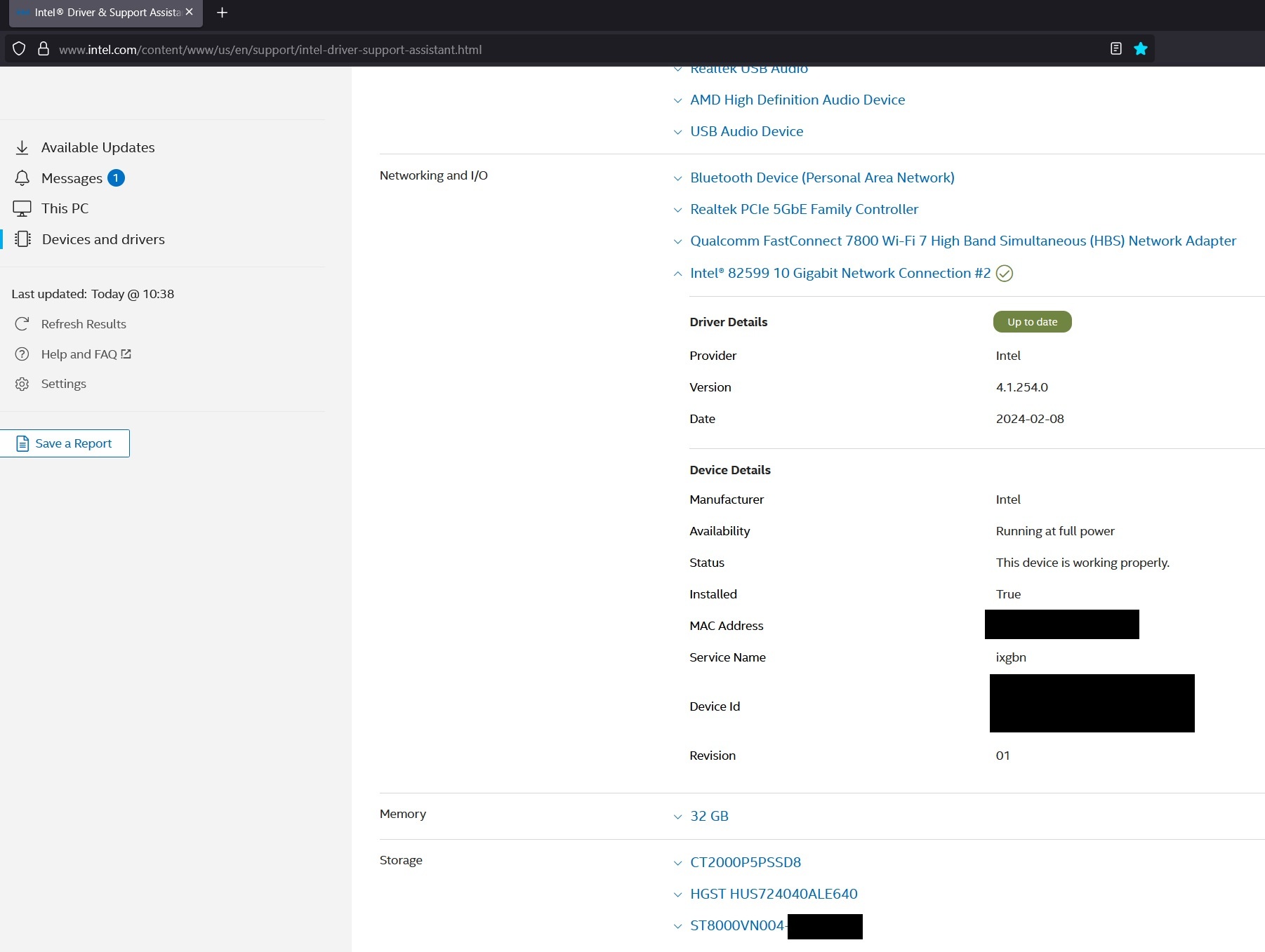

The problem with this though, was the 10gtek SFP+ 10g pcie card (i used this pcie card on all my devices, truenas, desktop, and backup truenas servers). The problem is this card only supported X8 and X16 slots. But this new MSI motherboard only came with 1 X16 slot which is already used by the graphics card. The other 2 pcie slots were only for X1 and X4 only.
So when i tested the 10gtek pcie card in the X4 slot, then check event viewer, it says not enough power and it wasn’t operating normally. There were some weird issues where intel driver installer assistant couldn’t detect the pcie card, and drivers manually downloaded couldn’t be installed.
But using an app called snappy driver installer origin aka SDIO (not to be confused for SDI which is a MALWARE), i managed to force the install for the intel driver and the card sort of worked.
But later it didn’t. it just behaves wonkily.
So i ordered a replacement from alibaba express which has a card that supposedly works for X4, X8 and X16.
So i installed that new card and it worked instantly no issues. Even the intel driver assistant detected it fine and said status was ok.
But i worry whether this card is legit 10g or not? because to my understanding for this pcie card with the intel chip lots of them perform sub par. So any advise how to test this to know?
These are my results
test is openspeedtest self hosted on truenas and using client desktop to test via the sfp+ 10g fiber lc to lc
Not quite 10g results i know :sweat_smile: My truenas has 4x seagate exos 12tb hard drives in raidZ1. I assume i would perhaps need 6 hard drives to be able to hit 10g speeds? i’m not sure, just guessing since 4 hard drives weren’t able to do it.
