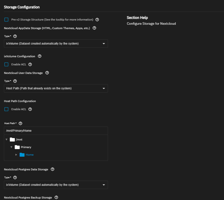

Here’s the installation screen
I’m pointing Nextcloud Used Data Storage to be TrueNAS user’s parent folder. Is this correct? Also do I have to check “Enable ACL?”
Also some say that it’s better to create a special dataset for nextcloud appdata and posgress data, but what’s wrong if this will be default ix-applications dataset?
