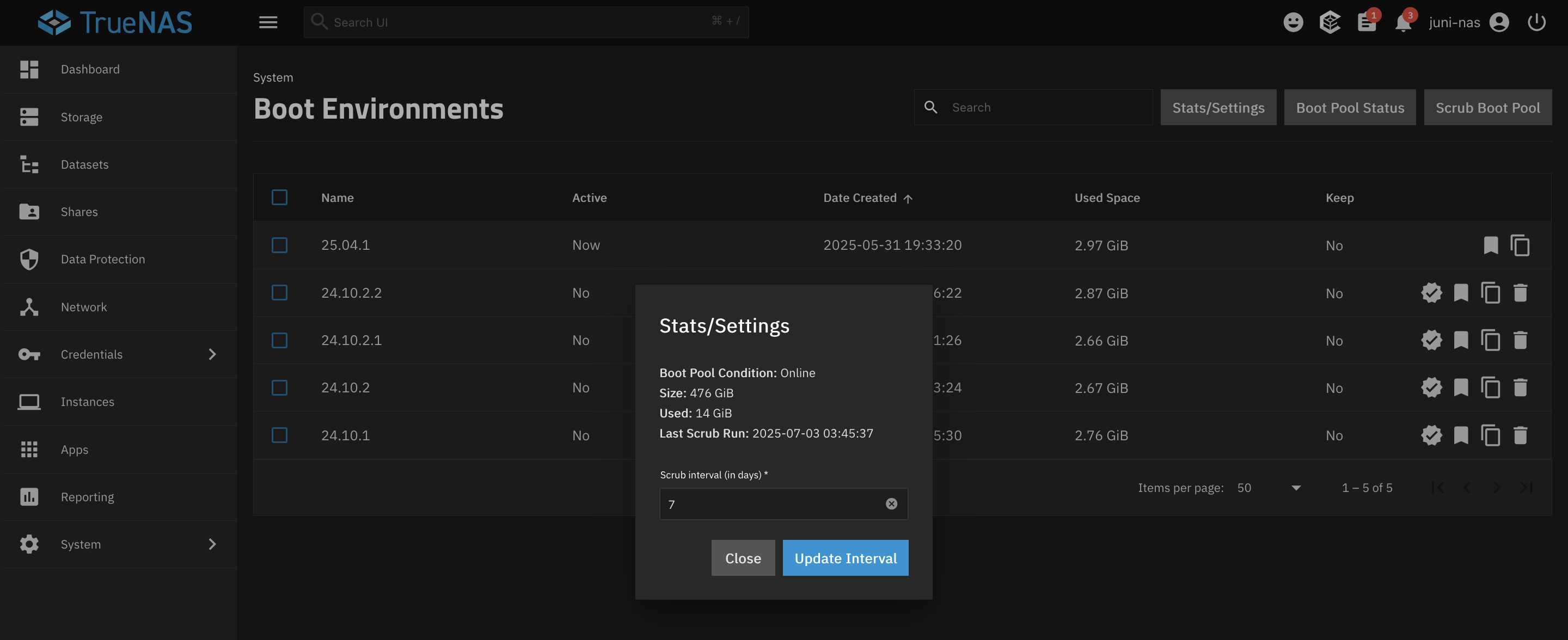

So, if it’s not the app (which i feel it may be…), would be a tad worried about the other two options you mentioned ( 2. failing boot device, 3. unexpected OS changes) and thought I’d ask if you had any advice on where to go next to troubleshoot/diagnose these as they’re both quite vague. I haven’t had boot issues or really any signs of system-level issues - my disk checks are all good, routine scrubbing for boot drive, data drives, etc…
Am booting off a single NVMe 476GB SSD… but the dataset that is throwing the space concerns, tank of tank/.system/cores, is referring to my 1 x RAIDZ1 | 3 wide | 21.68 TiB HDD pool which I use for data storage, so I don’t see how it would be a boot issue?
Just a bit confuzzled.
