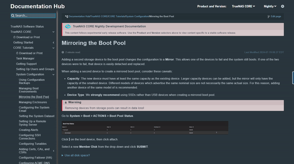

Great, thanks for the pointer. Can I do this with the regular stable build or do I need what stands at the top of the line of documentation you sent me: TrueNAS CORE Nightly Development Documentation, meaning a potentially unstable nightly build.

You can do this with stable builds of CORE/SCALE.
For some reason the documentation defaults to nightly, but the process is the same.

If you’re looking at a doc that doesn’t match your installed version, you can always use the version selector on the page to switch to the correct version.
VersionSelector
