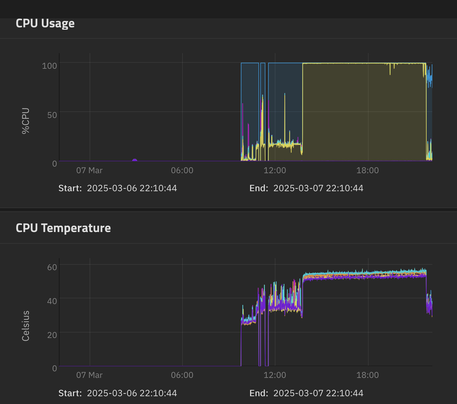

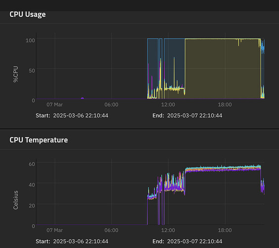

Edit: I did run Memtest86+ for more than 12 hours (atleast 8 passes) a month ago and it did pass. I will do it again.
Also, I have started the stress-ng on all cpu cores in a container for 8 hours - passed without any crashes.
Update -
  1. I did perform the stress-ng for 8 hours, and there were no crashes in that period.
  2. Memtest86 is running for 10 hours and completed two passes with no errors.
After the stress-ng test, I have encountered two more random reboots.

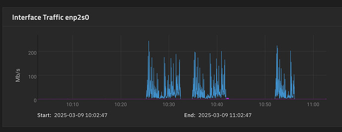

I did some more testing.
  1. I have disabled an app (paperless-ngx) that downloads a lot of stuff and writes it to the hard disk. With this disabled, I left the system, which has been online for 12 hours (currently). Next, I performed the scrub, but that did not result in a reboot.
  2. After 12 hours, I enabled that app, and a random reboot happened.
I am a bit confused now. Is it the network issue that is causing the reboot, or is it the HBA getting heated up during the writing that is causing the reboot?
Waiting for the cooling fan to arrive to rule out one or the other!
Around 10:25, I started the app, and the reboot happened at 10:42
