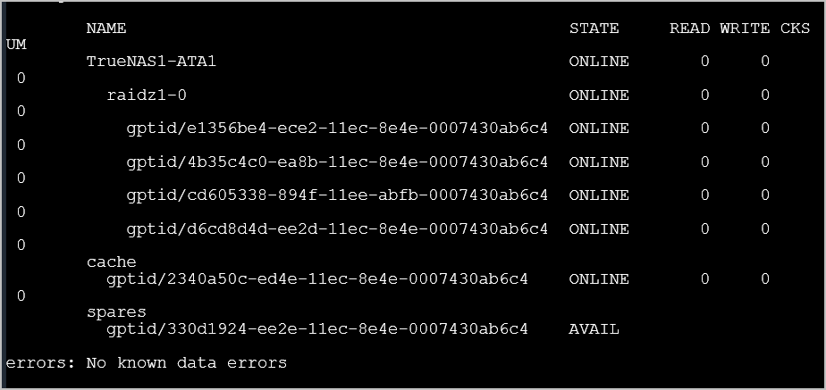

The spare is not actually part of the raidz1, if you can confirm that it is a “spare”
Maybe post your zpool status results just to confirm.
Yes, you should be able to just remove it. I think

Here is the status:
