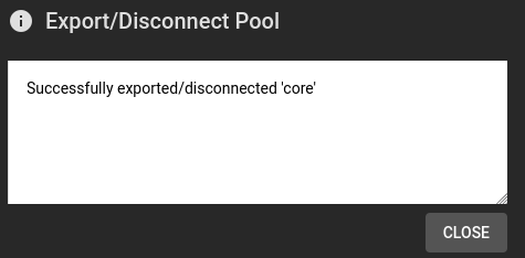

Via SSH I tried:
  1. Exporting the pool core via UI
  2. zpool import -o altroot=/mnt core dyingcore which spawns cannot import 'core': no such pool available
I also tried step 2. without exporting the pool as described in step 1 which also fails with the same message.
What am I doing wrong here?

It’s already imported. You need to export from the UI first. If that fails for a reason there should be a message that you can post here.

No problem, I appreciate you being so helpful already. Thank you for encouraging me. The following has been achieved so far:
  1. I exported pool core via UI as stated previously successfully.
  2. A sudo zpool import did not list pool core
