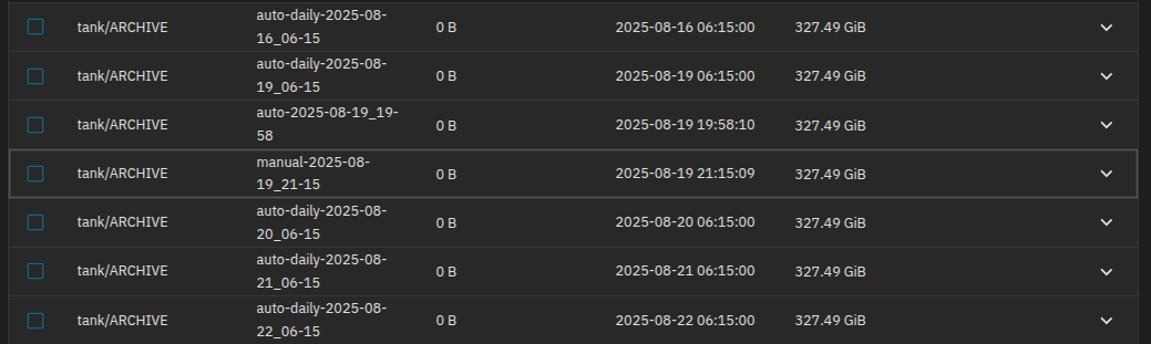

Here’s my dataset snapshots:

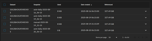

And here’s the replicated snapshots:

Your screenshots show values of 327GB for “referenced”. That’s a lot of data. I bet it’s close to the “usedds” value for the dataset itself.
This means that whatever snapshot shows “referenced” of 327GB, then it is a filesystem with 327GB of data if it is to be browsed or replicated to its own filesystem elsewhere.

I just wanted to know where that 8 KiB discrepancy comes from as I can’t find anything about it.
I guess the 8 KiB might be some harmless ZFS metadata differences but if anyone knows that would be cool.
Just ZFS metadata likely.
You might as well treat 8KB as nothing and ignore it.
