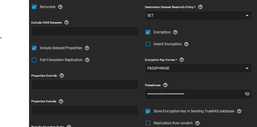

Hello @BoulderItalyc I tried to setup the Remote Encryption options and read the relevant documentation.
I did like that:
What I got is an encrypted dataset on the remote system but the encryption key is available to the remote system so all the files are readable on the remote TrueNAS.
(ideally) I would like the en/decryption key to be available only to the sending system which will get access to the dataset, store the updated data and lock it back again.

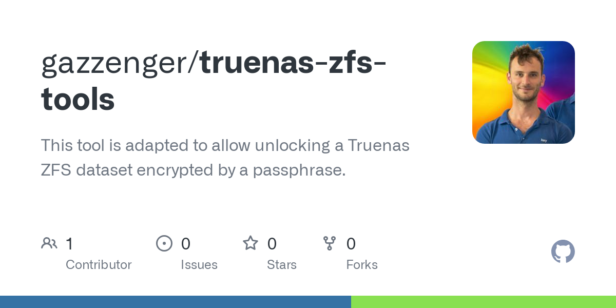

Here is a tool that might do what you want;
It does leave you open to someone accessing the data on the remote system while the dataset(s)/pool is unlocked. Probably low risk since you’ve presumably got strong passwords on accounts and not running services like SMB, but still not as secure as having no way at all of decrypting the data on the destination.
