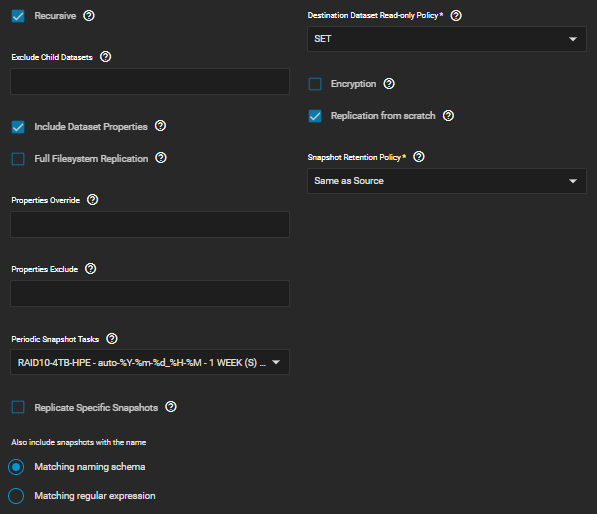

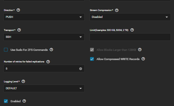

the Replication is setup from Primary Storage to Failover Storage with the Following Settings.
We had setup a Replication Task from One Truenas Scale Server to another Truenas Scale Server.

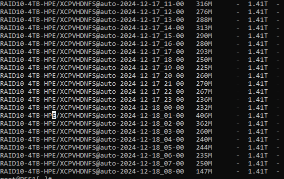

Here is my Primary Server Snapshots

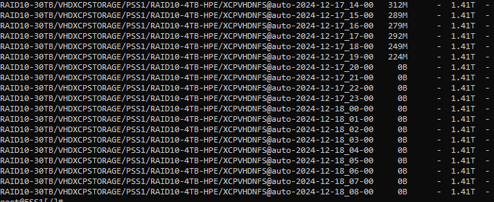

and below is the Failover Server Snapshots.
Why would the Failover Server now identify the Snapshots as 0B from 20:00 Pm on the Snapshots.
The Primary Server is a storage server for my hypervisor, and this is constantly changing on the System so the replicated Snapshots should resemble the same. What am i missing in this regards

As seen above in the OP’s screenshots, this is not the case as new snapshots was created on the source (hourly). It’s as if the initial job ran through with the initial seed, but when the 2nd job started, it was unable to get the snapshots to send and ultimately created blank snapshots on the destination side.
