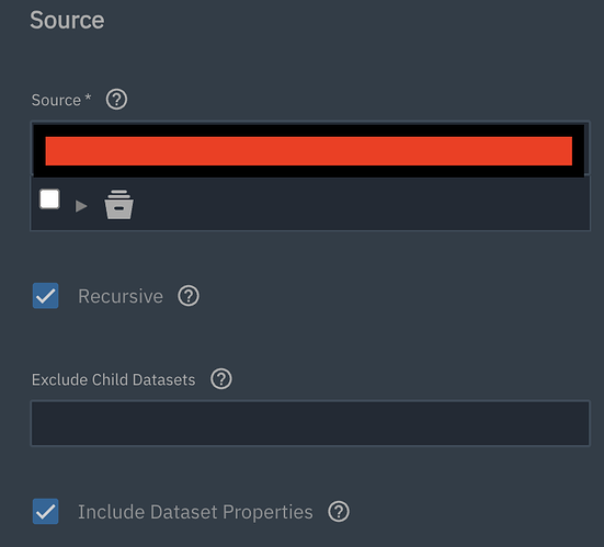

My pool appears on system B as you would like your dataset to - i.e. you decrypt the pool and all datasets (including children of datasets) decrypt also.
I wonder if enabling “recursive” and “include dataset properties” in your replication setup may enable the child datasets to correctly chain themselves to the “parent” dataset?
