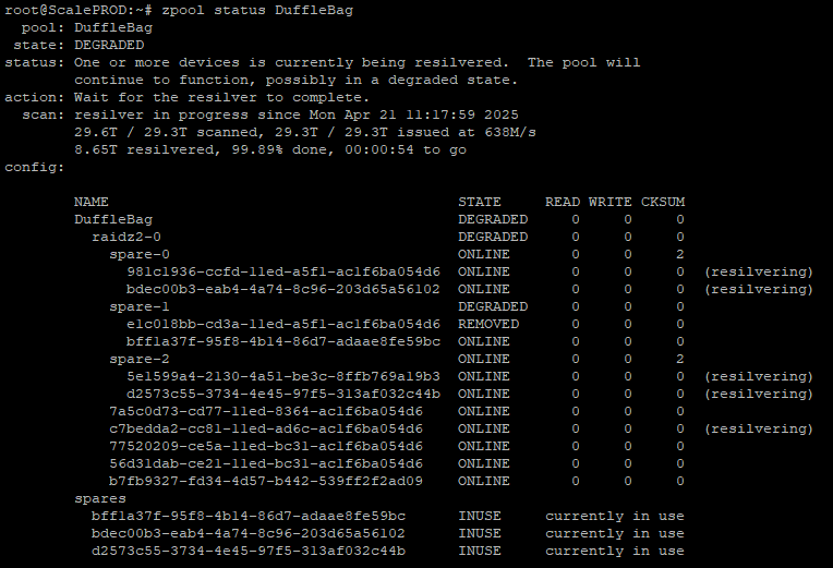

I have 8 12TB drives in a RaidZ2 format. I recently added 3 other HDDs to a SPARE vdev. I think I am starting to regret that move.
A drive reported an error, spare swapped in automatically and resliver started. That triggered another drive to error and another swap, and another error.

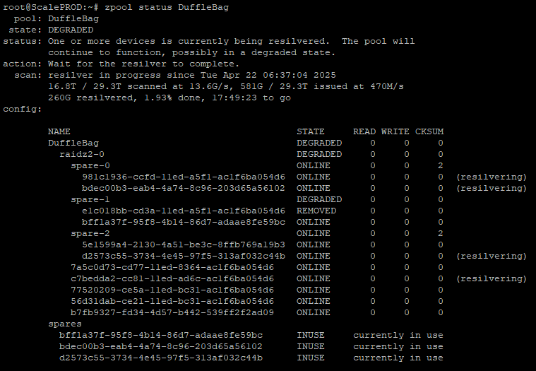

Anyway … 4 days of reslivering has given me this …
zpool status screenshot
previous zpool status screenshot
I suppose it is getting better.
Suggestions? Just wait. And wait?

7 hrs for this resliver to finish … and the next one to start :).

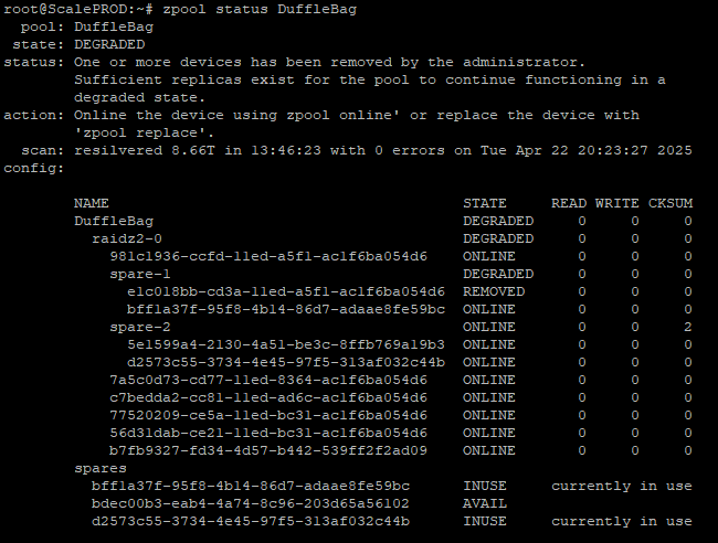

Resliver finished. Finished for 40 mins now without kicking of another one. Here is the current status …
current zpool status
Now … if I am reading this correctly,
  • bff (first 3 letters of guid) is mirrored with elc
  • elc is dead … and I can pull it / replace it
  • 5eo is mirrored with d25
  • spare bff is in use
  • spare d25 is in use
So … I think my next step is to replace elc with bde. Is that what I should be doing?

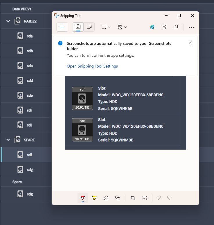

Something weird about my spares. I have 10 disks. 8 in Raidz2 with 2 hot spares. For some reason, it was showing me 3 hot spares. I had to detach the ‘free’ hot spare and then use that disk to replace the removed disk.

Resliver finished. Status is now healthy. I still have 2 spares attached in the SPARES vdev, one in use and one available. I removed the available one.
GUI reports 2 drives available to add to a pool (the spare I just removed) and another that is actually part of a pool (see screenshot).
disks in pool and disks available to add to pool
Why does sdf appear in both groups?
Can we see the output of zpool status
I’ve resolved this duplicate name issue. I replaced one of them with a genuine spare disk. Once I got rid of all of the mirrors, I removed the hot spare vdev.
