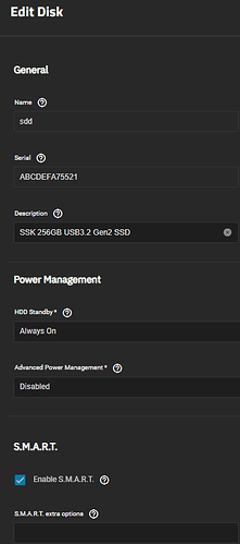

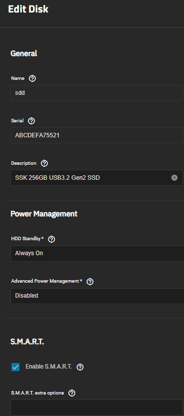

You could try putting -d sat in the SMART extra options box on the Edit screen for this device:
There is no “SMART extra option”. Maybe it needs to be activated somehow?
The SMART Extra Options went away when I filed a ticket stating it didn’t work and asked for advice on how to make it work.
Yes, this is normal smartctl operation when it comes to USB connected drives. Smartctl does not know what the interface is so you get to manually configure it.

My goal is to be able to monitor disk status through the standard TruNAS interface. To do this, I want to add the “-d sat” parameter to smartctl for a USB connected disk, but I don’t know how to do it.
Unfortunately as far as I am aware, you cannot do this. I believe the SMART Options was originally intended for that type of operation however it was never implemented and for years, never used, thus iXsystems is removing it since it was never actually operational. This is based from a Jira ticket I filed and was recently closed. I too wanted to use -d sat or whatever was required to make the interface work.
