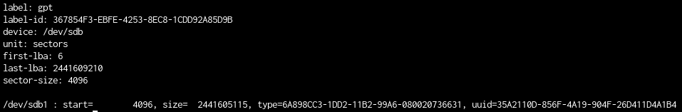

Please identify your 10T He10 drive (Storage → Disks) and then issue the command
sudo sfdisk -d /dev/sdX
where sdX is the device that is your He10
Post the output in codeblocks (three backticks) here if possible.
Sorry, copying doesn’t work from the Truenas shell, so I attach a screenshot:
To copy from the Truenas shell, highlight the info to copy then use ctrl-insert to copy. Use shift-insert to paste into the shell.
Thanks, yes, I got that info from the emulator. It’s just that I don’t have an insert key. :slight_smile: I generally don’t recognize it as being useful and I remapped it to be my compose key which has more utility for me. This is the first instance in my life when I actually needed the insert key.
You may want that functionality for these steps, we’ll be doing a bit of text here. :stuck_out_tongue:

EDIT: Adding the He10 output again in text:
He10:
label: gpt
label-id: 367854F3-EBFE-4253-8EC8-1CDD92A85D9B
device: /dev/sdb
unit: sectors
first-lba: 6
last-lba: 2441609210
sector-size: 4096
/dev/sdb1 : start=        4096, size=  2441605115, type=6A898CC3-1DD2-11B2-99A6-080020736631, uuid=35A2110D-856F-4A19-904F-26D411D4A1B4
