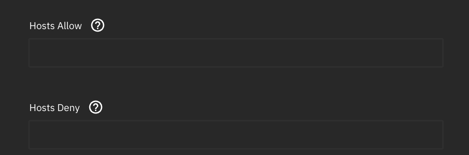

I just realized that there are settings to allow and/or block hosts for Samba shares. Is there a way to set default options for each, or is manual edits to individual shares the only option?
