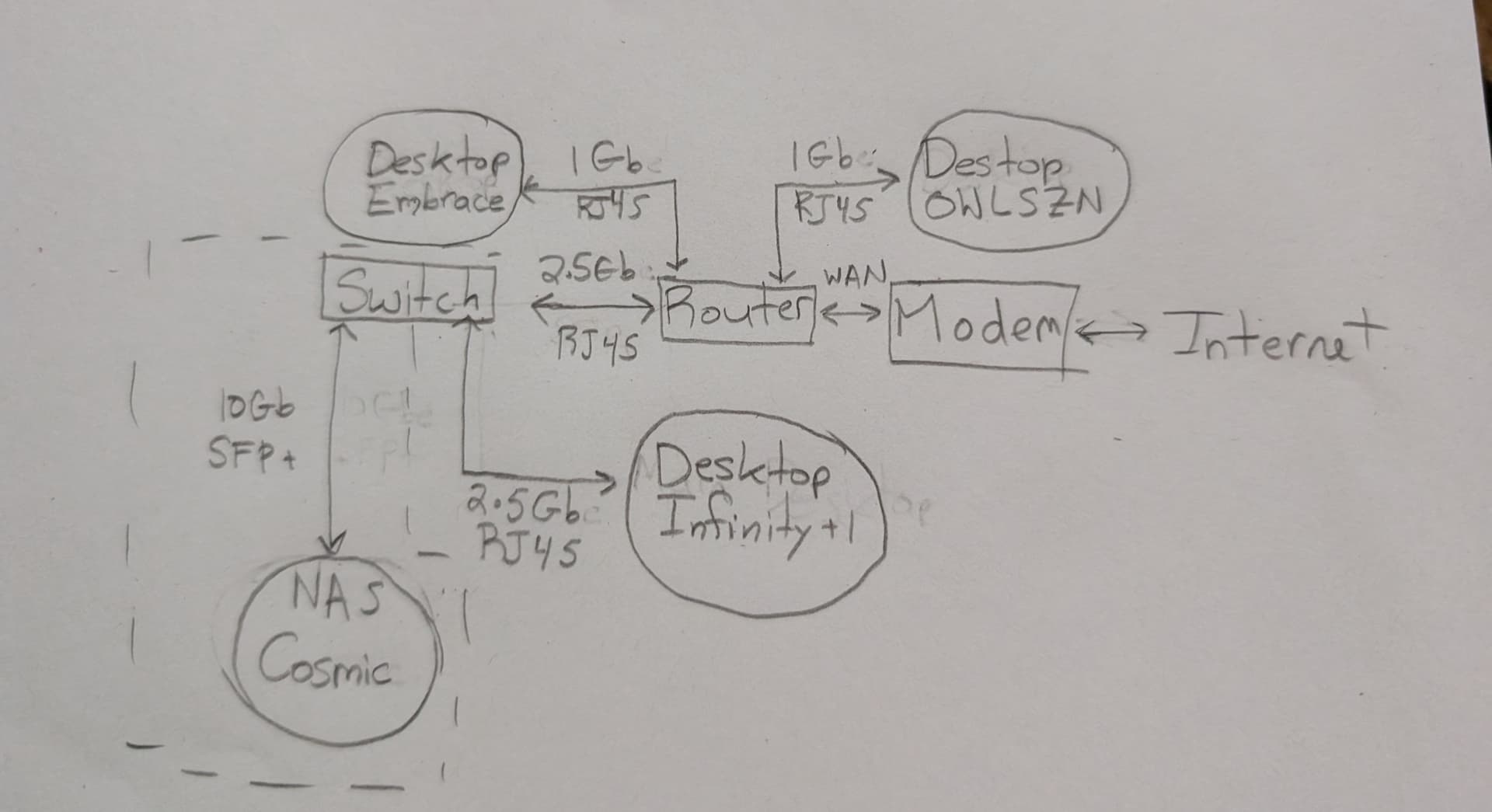

Forgive the rough sketches but here’s the overall view after your suggestions

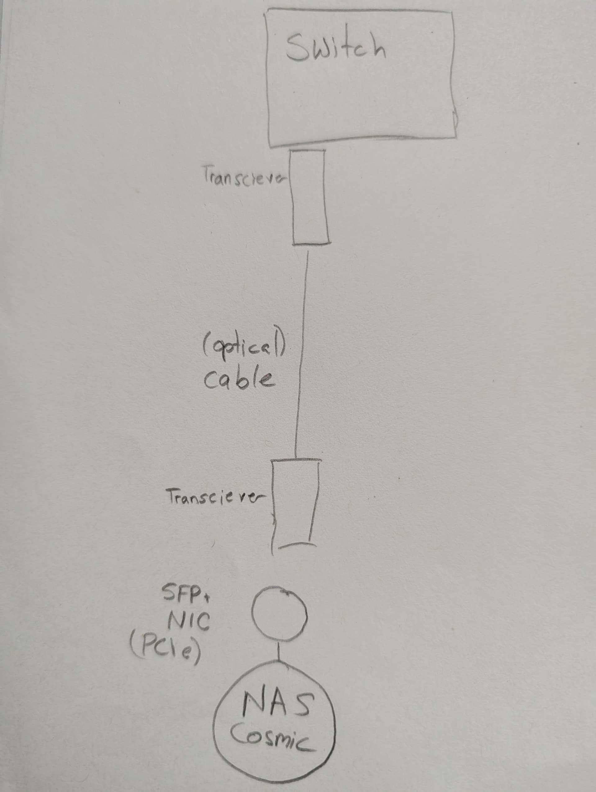

Here’s the zoom in on the switch to NAS connection since that’s SFP+ and i’ll have to source that whole connection here in the US.
That should work
The Owl & Embrace desktops can also be plugged into the switch unless they are on different vlans or are running as DMZ devices
Thanks!
I figured to leave them on the router vs the switch because they only support 1Gb connections, but it’s not like i have anything faster to plug into that switch either.
