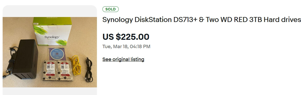

WD Gold Enterprise drives are the way to go in my experience. Never had one die on me. And just let a couple 10 year Gold drives go that were still working perfectly. Just felt like it was time but who knows. They are rated for, like, 25 years. And, yup, they are 7200 rpm drives.
I don’t believe you. Prove it. Send the drives to me.
I can prove I sold my Synology NAS with two 3Tb drives. Not sure when they last made a 3TB Gold drive but I suspect a while back. I can’t prove the Smart test I ran indicated the drives had 10 years of use. Will attempt to upload
a screen shot of my sale of the NAS and drives.
Hmmm, looks like they were Red drives. So I don’t believe me either. LOL. But they did last 10 years.
