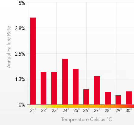

5400 RPM drives do tend to operate at a lower temperature, but is that even important? Some studies have found a correlation between temperatures and failure rates, but it’s important to point out that correlation does not imply causation. And Backblaze did their own study and found no correlation between drive temperatures and failure rates. 5400 RPM drives can be nice because they’re quieter, too.

While they have done a great job with this research, it is probably not applicable to home use. They have their drives temperatures between 15°C and 30°C. My drives run for 36-42°C (mostly dependent on ambient temperature).
This reminds me of similar research made by Microsoft (IIRC). And they didn’t find significant difference in AFR between drives with 18°C and 28°C.
Same thought is in the first comment for this very research:
Jack McDonald 9 years ago
You can’t measure between 21 and 31 degrees celcius and say there’s no correlation. That’s like saying cigarettes have no correlation with cancer because 0 a month and 1 a month have the same results.
You need to test right up to the ‘Operating Temperatures’ of ~60 degrees.
So, unless you have a 24/7/365 air-conditioned server room, this research is not applicable.

If there was a causal effect between heat and drive failures, it’d be present in a large enough sample size. It might be negligible at the lower temperatures in the study–but it’d still be present if it were statistically significant.
It’s actually applicable, but how applicable is probably requires a degree of independent. When you consider the published operating temperature ranges for hard drives, I’d argue that your home is probably much more like a “24/7/365 air-conditioned server room” than you realize it is.
In order for it to be “not applicable”, there would need to be a similarly-sized study proving otherwise. Unfortunately, that probably won’t be happening any time soon.

It’s not that Backblaze’s results don’t establish a correlation of drive temps and drive failures, but those who run their HDDs under higher ambient temperatures can’t really gauge how much of a difference it applies to them.
In fact, some of Backblaze’s data shows that increasing the temps decreases the failure rate. Look at the trend from 24 → 30 degrees.
Imagine if their cutoff was 30C.
“Heat is a good thing!”
“What we can deduce is a correlation between drive temps and failure rates. As the drive temps increase, the failure rates decrease!:nerd_face:
I agree with @swc-phil and the highest rated comment on their blog: This data has no use for most home users, whose drive temps easily reach anywhere from 34 to 40+ C.
Why is that so? I do believe that at 100°C, the drive wouldn’t survive very long. And yet there is no sign of it in the aforementioned statistics.

That’s an image for a very particular Hitachi drive from the Backblaze blog which they even describe as “non-typical.”
You’re manipulating and misrepresenting that image to try and prove a point for an imaginary “what-if” scenario that isn’t happening

I could have left 31C in there. Why didn’t they shown us data for drives up to 55C? How is it other than the often cited Backblaze data that the mantra has otherwise been “improve airflow and cooling for your drives”? Was it always just an old wives tale?
Which raises the question, what use is it, as “large” as the number of drives being studied, when they are only collecting data for a range of temps that home users are unlikely to operate.
We might learn that after a certain point, not only do higher drive temps correlate to failure rate, but that the effect increases with every iteration above a certain threshold.
