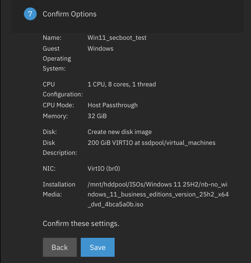

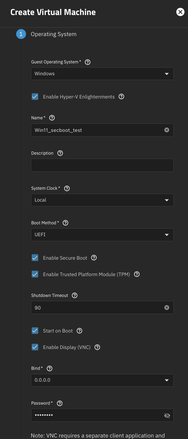

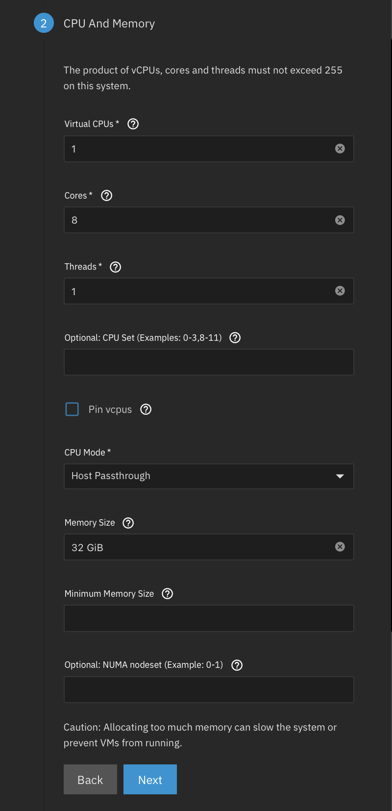

I made one test VM for Windows 11 and one for Debian Trixie. Windows process below:

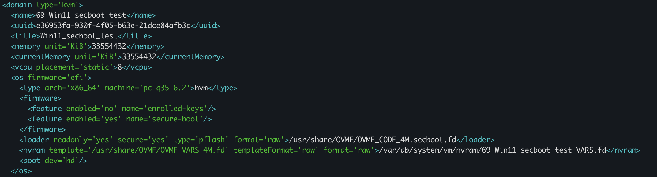

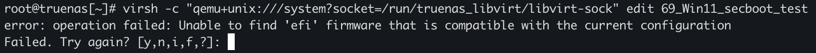

Checking the config with virsh since OS say Secure Boot not enabled:
Here we can see that <feature enabled='no' name='enrolled-keys'/> and that /usr/share/OVMF/OVMF_VARS_4M.fd is used as template for VARS.

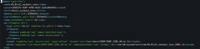

Trying to set <feature enabled='yes' name='enrolled-keys'/>:
Checking if the VARS file used has Secure Boot keys:
Nothing.

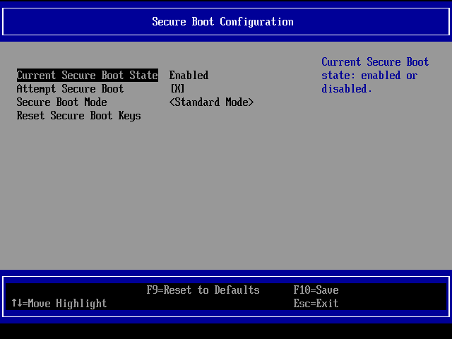

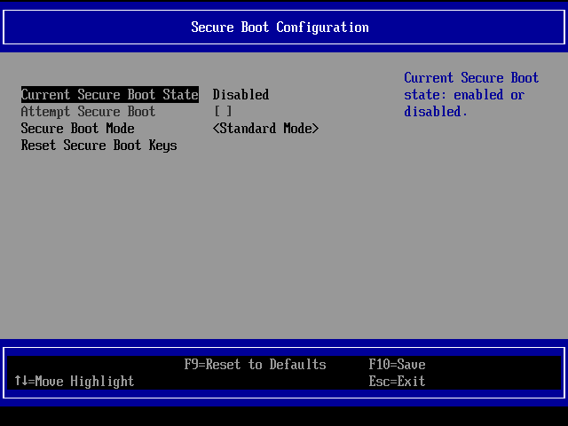

Screenshot from UEFI Setup → Device Manager → Secure Boot Configuration in the non functional VM:

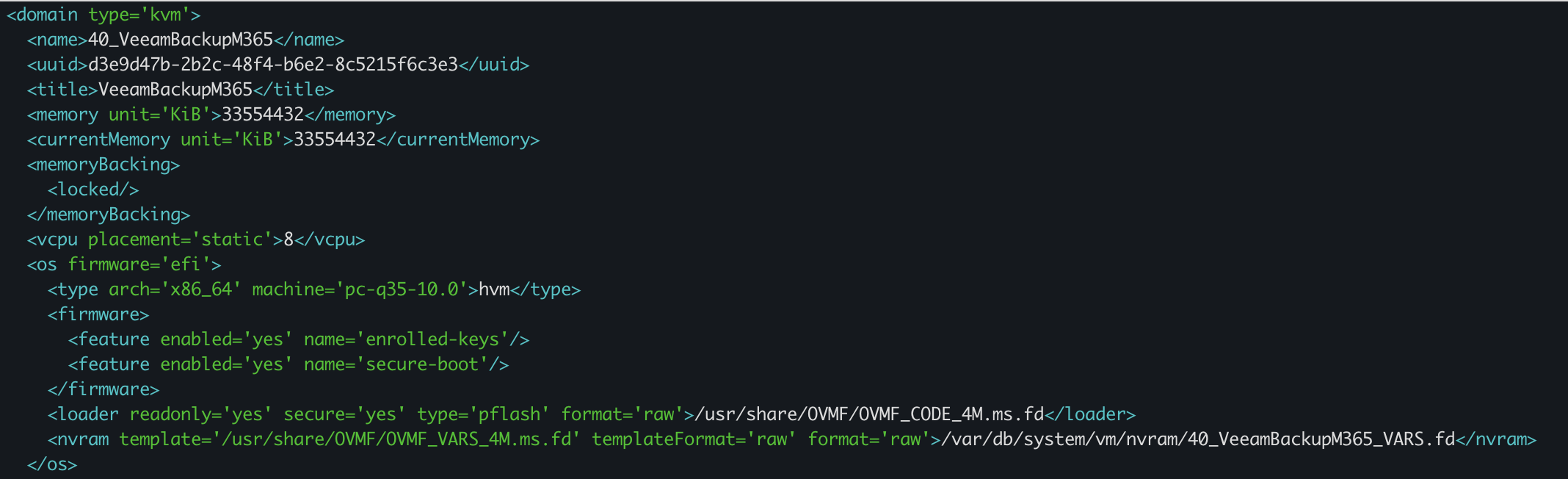

Looking at older pre 25.04 VM that has working Secure Boot with virsh:
It has enrolled keys enabled: <feature enabled='yes' name='enrolled-keys'/>

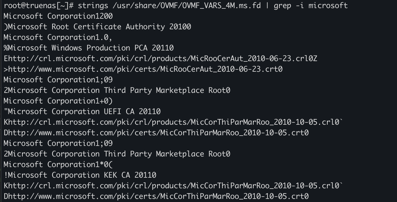

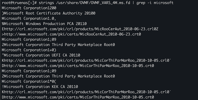

Checking if the VARS template file used has Secure Boot keys:

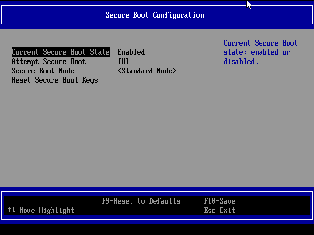

Screenshot from UEFI Setup → Device Manager → Secure Boot Configuration in the functional VM:

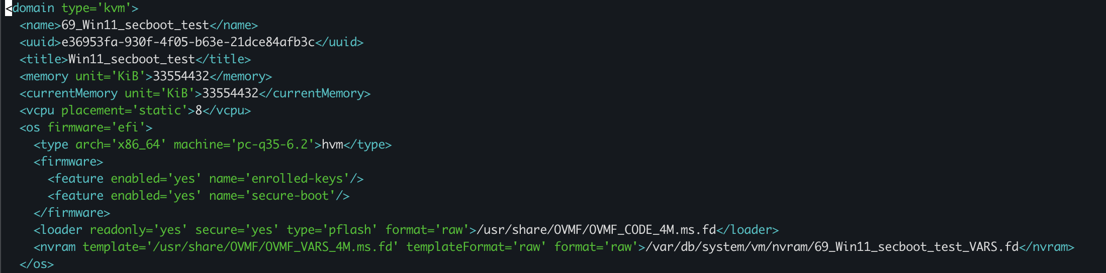

I managed to get this working now by deleting the VARS file from /var/db/system/vm/nvram/ and changing the bootloader via SQLite (not ideal):
UPDATE vm_vm SET bootloader_ovmf='OVMF_CODE_4M.ms.fd' WHERE id=69;
And there you go:
