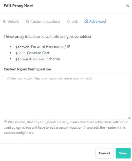

@swc-phil I add the custom config in the NGINX gui:

When installing the app in TrueNAS, the authentik_host defaults to the local IP, so you have to fix it.
Doing the above FINALLY made it work for me after fudging/debugging/error logging for an hours. AI was useless, of course, so I had to resort to good 'ol searching, reading, stack overflow etc.
