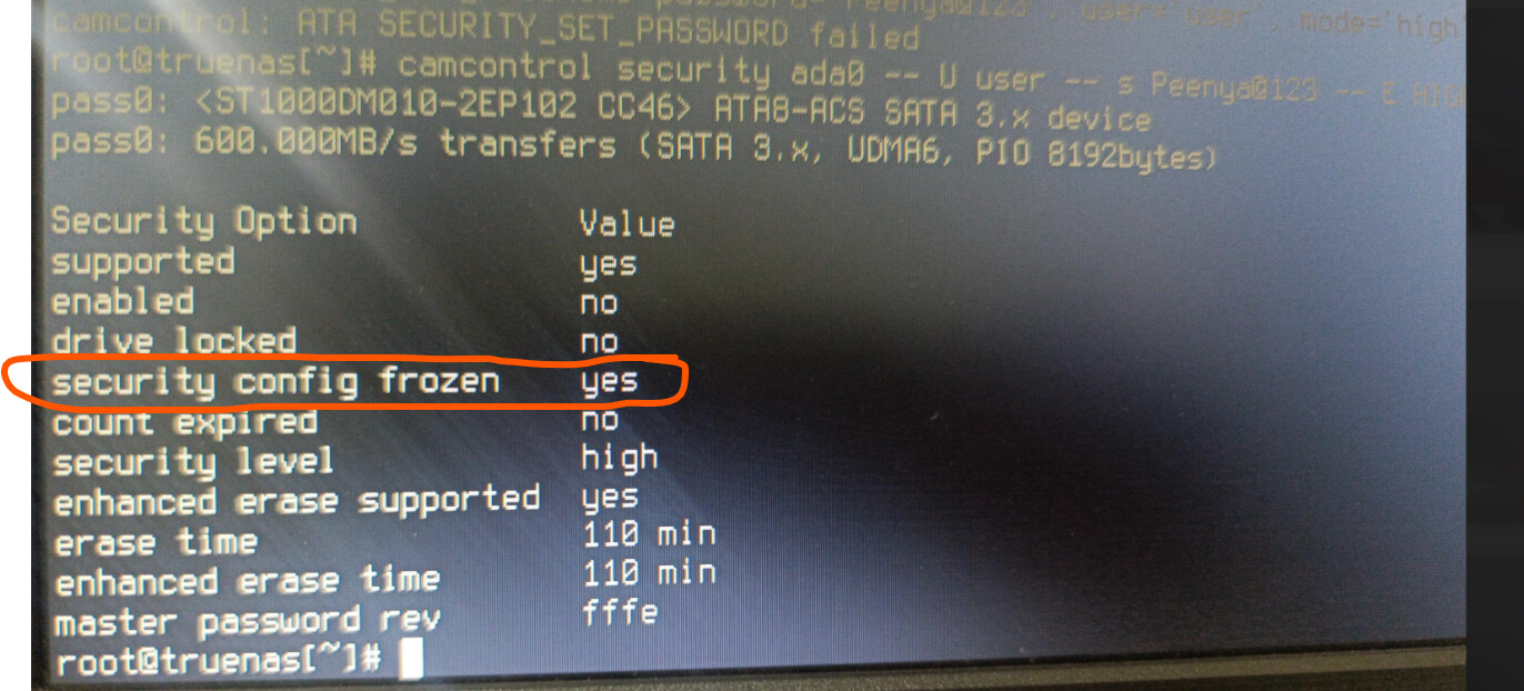

I was trying to test/implement SED( self Encrypting Drive) feature on my TrueNAs Core. But I see that the security config frozen status is “yes” due to which not able to set password.
Please let me know how to unfroze the hard disk status ( ada0) so that I can set the password and test SED feature.
I am using ASUS motherboard Intel 11th Gen processor.
I tried some methods like disable security mode in BIOS but still not able to unfreeze the hard disk.

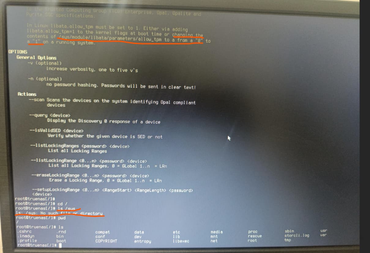

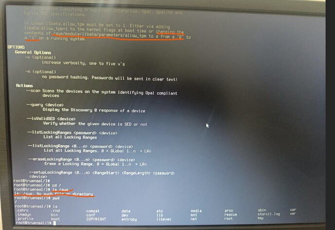

Read in man page of sedutil-cli that we need to enable tpm by editing /sys/module/libdata/parameters/allow_tpm from 0 to 1.
But I cannot find /sys folder in my True NAS Core.
Any idea about this.
Also I tried updating the libata.allow_tpm=1 at the loader prompt( ok shell) but still cannot make the “sedutil-cli --query /dev/ada0” command work.
I tried the command “sedutil-cli --isValidSED /dev/ada0” - it says NO.
Any idea why? how can we know a hard disk is SED enable or not??

I should be working only with camcontrol command only. but even there, I am not able to set the password.

Please help me how to unfreeze the hard disks so that I can enable security and set the password for locking and unlocking using Camcontrol command.
Some one please guide me here.
how to unfroze the hard disks so that I can enable security
