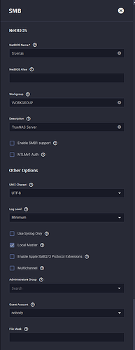

I’m having some issues with an application. This application is running in a container on a separate VM and is using a drive mounted via SMB.
I’m not 100% sure that changing mangled names to no will fix the issue, but it’s a troubleshooting step I’ve seen work for some others.However, I can’t seem to figure out how to do this on SCALE.

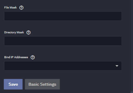

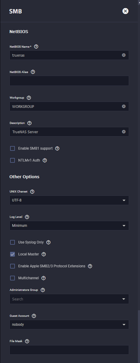

The documentation states that there is an “Auxillary Parameters” configuration option for this purpose, but I don’t see that when I go to Services > SMB.
I have attached an image of what I see on my system.
I am on the latest stable, 24.04.
Am I missing something?

The Aux-Parameter field has been removed with cobia i believe. It’s intentionally no longer there because there were problems with users setting aux parameters and a lot of problems/bug reports with them.
