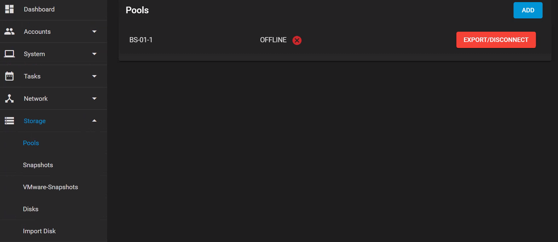

I’m a complete TrueNAS beginner, having recently inherited a system from a previous regime, and would like to ask for help creating a new pool and making it available to a Veeam Backup & Replication server via iSCSI. Unfortunately I’ve hit a stumbling block early on.
We had a failed disk on the system a while ago, and unfortunately there were no identifiers in TrueNAS to allow us to correctly identify which of the disks was the failed one. The hardware itself is very primitive and similarly does not include any fault indicators (this is not an HPE server with hot-swappable disks - it’s a bare metal chassis with disks connecting to the motherboard using moulded plastic connectors, the whole thing has to be switched off, unmounted from the rack and the disks disconnected and unscrewed with a screwdriver). Unfortunately, in the process of elimination we had to follow, the wrong disk was removed and we lost the array, so now it needs to be rebuilt.
I am left with two storage pools (one of which is the system dataset pool (though I don’t understand what this means) which have the error ‘OFFLINE’. I tried to delete the first pool (named BS-01-1) but this failed; I then tried to delete the second one (BS-01-2, which was the system dataset pool) and this failed too, but in the process it moved the system dataset pool onto the first pool.
A second attempt was made to delete the second pool, and this succeeded. I’ve tried to do the same to the first pool, but am getting an error, which is:

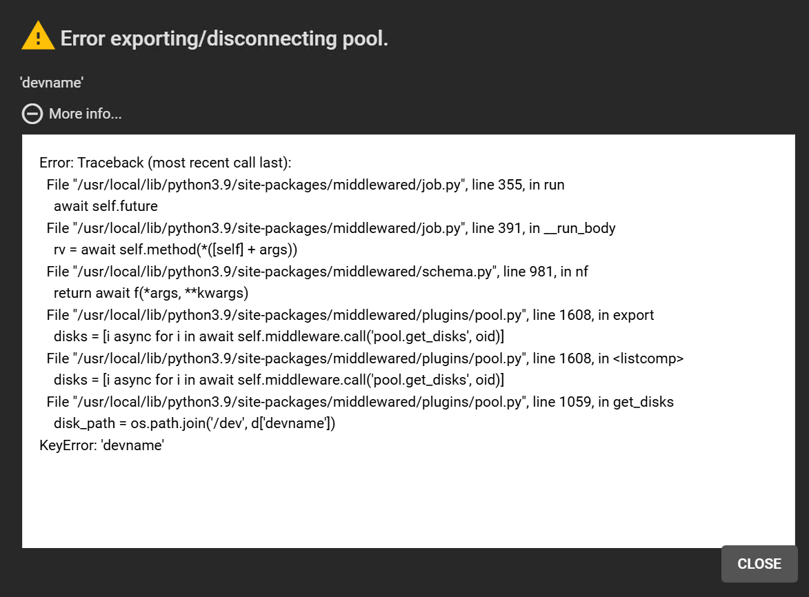

Error exporting/disconnecting pool
‘devname’
More info…
File “/usr/local/lib/python3.9/site-packages/middlewared/job.py”, line 355, in run
await self.future
File “/usr/local/lib/python3.9/site-packages/middlewared/job.py”, line 391, in __run_body
File “/usr/local/lib/python3.9/site-packages/middlewared/schema.py”, line 981, in nf
File “/usr/local/lib/python3.9/site-packages/middlewared/plugins/pool.py”, line 1608, in export
disks = [i async for i in await self.middleware.call(‘pool.get_disks’, oid)]
File “/usr/local/lib/python3.9/site-packages/middlewared/plugins/pool.py”, line 1059, in get_disks
disk_path = os.path.join(‘/dev’, d[‘devname’])
KeyError: ‘devname’
I don’t have the expertise to be able to decipher this output unfortunately.

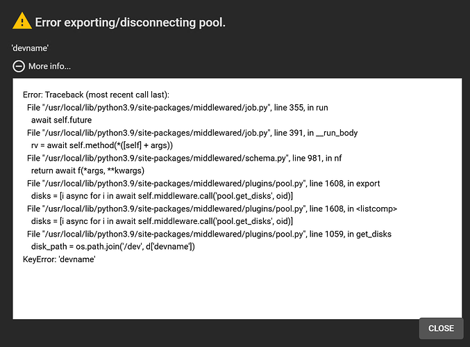

If I try to create a new pool I get the following error:
KeyError
‘devname’
More info…
File “/usr/local/lib/python3.9/site-packages/middlewared/main.py”, line 139, in call_method
result = await self.middleware._call(message[‘method’], serviceobj, methodobj, params, app=self)
File “/usr/local/lib/python3.9/site-packages/middlewared/main.py”, line 1240, in call
File "/usr/local/lib/python3.9/site-packages/middlewared/plugins/disk
/availability.py", line 21, in get_unused
reserved = await self.middleware.call(‘disk.get_reserved’)
File “/usr/local/lib/python3.9/site-packages/middlewared/main.py”, line 1283, in call
return await self.call(
/availability.py", line 44, in get_reserved
reserved += [i async for i in await self.middleware.call(‘pool.get_disks’)]
File “/usr/local/lib/python3.9/site-packages/middlewared/plugins/disk/availability.py”, line 44, in
KeyError: ‘devname’
Similarly unclear.

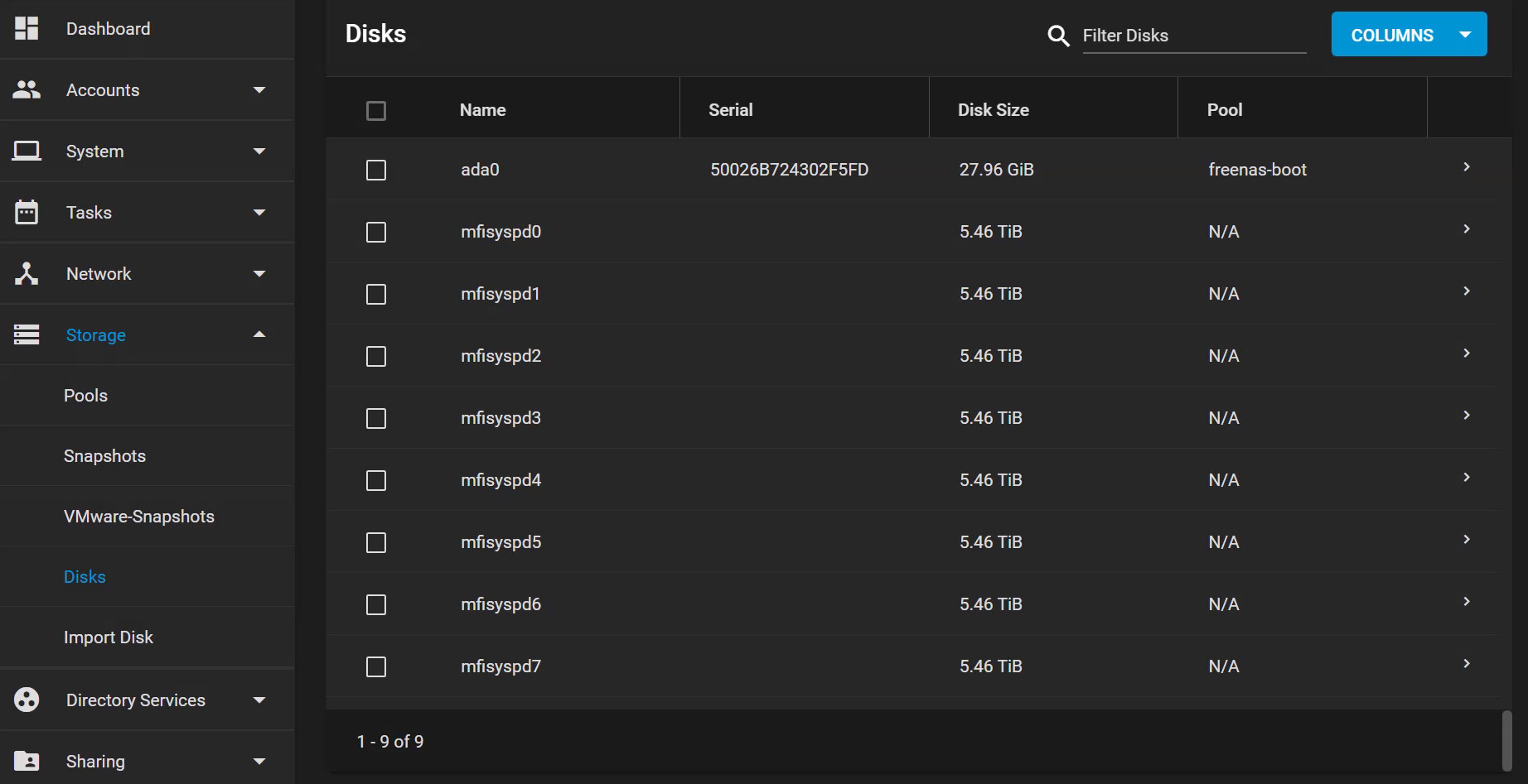

In parallel to the above, I’m still unable to add a new pool - indeed, the GUI shows there are no drives available, even though I have 8, which strikes me as suspicious.
I can see all disks in Storage > Disks, but when I try to run a short smart test on them, I get the following error:
ValidationErrors
[EINVAL] disks.0.identifier: {uuid}7ee22a01-743b-11ef-84d7-001b2166eed3 is not valid. Please provide a valid disk identifier.
(Each disk produces the same error, just with a different identifier.)

mfisyspd0 on mfi0
mfisyspd0: 5723166MB (11721045168 sectors) SYSPD volume (deviceid: 13)
mfisyspd0:  SYSPD volume attached
ugen2.1: <Intel UHCI root HUB> at usbus2
ugen1.1: <Intel UHCI root HUB> at usbus1
ugen0.1: <Intel UHCI root HUB> at usbus0
ipfw2 (+ipv6) initialized, divert enabled, nat enabled, default to accept, logging disabled
uhub0 on usbus0
uhub0: <Intel UHCI root HUB, class 9/0, rev 1.00/1.00, addr 1> on usbus0
mfisyspd1 on mfi0
mfisyspd1: 5723166MB (11721045168 sectors) SYSPD volume (deviceid: 14)
mfisyspd1:  SYSPD volume attached
ugen3.1: <Intel UHCI root HUB> at usbus3
uhub1 on usbus1
ugen4.1: <Intel EHCI root HUB> at usbus4
uhub1: <Intel UHCI root HUB, class 9/0, rev 1.00/1.00, addr 1> on usbus1
uhub2 on usbus4
uhub2: <Intel EHCI root HUB, class 9/0, rev 2.00/1.00, addr 1> on usbus4
uhub3 on usbus3
uhub3: <Intel UHCI root HUB, class 9/0, rev 1.00/1.00, addr 1> on usbus3
uhub4 on usbus2
uhub4: <Intel UHCI root HUB, class 9/0, rev 1.00/1.00, addr 1> on usbus2
mfisyspd2 on mfi0
mfisyspd2: 5723166MB (11721045168 sectors) SYSPD volume (deviceid: 15)
mfisyspd2:  SYSPD volume attached
mfisyspd3 on mfi0
mfisyspd3: 5723166MB (11721045168 sectors) SYSPD volume (deviceid: 16)
mfisyspd3:  SYSPD volume attached
mfisyspd4 on mfi0
mfisyspd4: 5723166MB (11721045168 sectors) SYSPD volume (deviceid: 17)
mfisyspd4:  SYSPD volume attached
mfisyspd5 on mfi0
mfisyspd5: 5723166MB (11721045168 sectors) SYSPD volume (deviceid: 18)
mfisyspd5:  SYSPD volume attached
mfisyspd6 on mfi0
mfisyspd6: 5723166MB (11721045168 sectors) SYSPD volume (deviceid: 19)
mfisyspd6:  SYSPD volume attached
mfisyspd7 on mfi0
mfisyspd7: 5723166MB (11721045168 sectors) SYSPD volume (deviceid: 20)
mfisyspd7:  SYSPD volume attached
mfi0: 33597 (boot + 36s/0x0002/info) - Inserted: PD 0d(e0xff/s0) Info: enclPd=ffff, scsiType=0, portMap=02, sasAddr=4433221103000000,0000000000000000
mfi0: 33598 (boot + 36s/0x0002/info) - Inserted: PD 0e(e0xff/s1)
Trying to mount root from zfs:freenas-boot/ROOT/13.0-U6.2 []...
mfi0: 33599 (boot + 36s/0x0002/info) - Inserted: PD 0e(e0xff/s1) Info: enclPd=ffff, scsiType=0, portMap=04, sasAddr=4433221102000000,0000000000000000
mfi0: 33600 (boot + 36s/0x0002/info) - Inserted: PD 0f(e0xff/s3)
mfi0: 33601 (boot + 36s/0x0002/info) - Inserted: PD 0f(e0xff/s3) Info: enclPd=ffff, scsiType=0, portMap=00, sasAddr=4433221100000000,0000000000000000
mfi0: 33602 (boot + 36s/0x0002/info) - Inserted: PD 10(e0xff/s2)
mfi0: 33603 (boot + 36s/0x0002/info) - Inserted: PD 10(e0xff/s2) Info: enclPd=ffff, scsiType=0, portMap=05, sasAddr=4433221101000000,0000000000000000
mfi0: 33604 (boot + 36s/0x0002/info) - Inserted: PD 11(e0xff/s7)
mfi0: 33605 (boot + 36s/0x0002/info) - Inserted: PD 11(e0xff/s7) Info: enclPd=ffff, scsiType=0, portMap=06, sasAddr=4433221104000000,0000000000000000
mfi0: 33606 (boot + 36s/0x0002/info) - Inserted: PD 12(e0xff/s4)
mfi0: 33607 (boot + 36s/0x0002/info) - Inserted: PD 12(e0xff/s4) Info: enclPd=ffff, scsiType=0, portMap=03, sasAddr=4433221107000000,0000000000000000
mfi0: 33608 (boot + 36s/0x0002/info) - Inserted: PD 13(e0xff/s5)
mfi0: 33609 (boot + 36s/0x0002/info) - Inserted: PD 13(e0xff/s5) Info: enclPd=ffff, scsiType=0, portMap=07, sasAddr=4433221106000000,0000000000000000
mfi0: 33610 (boot + 36s/0x0002/info) - Inserted: PD 14(e0xff/s6)
mfi0: 33611 (boot + 36s/0x0002/info) - Inserted: PD 14(e0xff/s6) Info: enclPd=ffff, scsiType=0, portMap=01, sasAddr=4433221105000000,0000000000000000

From what I can tell, this hasn’t recognised the presence of any other pools, but the screenshot from the remnants of the pool I wasn’t able to delete, because of the below-screenshotted error:
If you are not saving any data, I would just do a completely fresh install unless you are trying to save the current users and other things on that machine. Document any network settings and such so you can recreate them.
If you want to work with what you have already, we can try to destroy the current data pools and start over. Please post screenshots of the Storage-Pools and Storage-Disks tabs or pages from the GUI. I can try to follow along with a VM of TrueNAS-13.0-U6.8
Consider going to the latest version of TrueNAS Core, TrueNAS-13.0-U6.8 or moving to TrueNAS Scale. I would suggest Fangtooth TrueNAS-SCALE-25.04.2.6. Core is FreeBSD based and Scale is Debian Linux based. Scale is getting further development and Core, maybe security updates?
Yes, I was hoping to avoid wiping the whole system because that would necessitate a much larger time investment in learning how the whole thing works. I’m not planning to run it long term, but I do need it right now.
Here are the screenshots:
Many thanks once again.
@HoneyBadger User is on Core. Do you have any feedback on clearing pool error and creating new pool(s)?
The Supermicro X7 series is seriously vintage. I’m not trying to bag on your hardware here, but that’s DDR2 and FBDIMM era. If this is being used for anything critical - like a backup target - your organization might want to look at refreshing this hardware to something newer (or contacting the friendly folks at TrueNAS to get you into an entry-level Enterprise unit :wink: )
This is what’s likely tripping you up. Your storage controller is using the mfi driver which means it’s using the MegaRAID firmware, and likely has virtual drives defined in the boot ROM - those are the mfisyspd devices. They should be showing up as da0 through da7 which would indicate the correct driver.
Thankfully, because you have a “clean slate” you could crossflash this controller into HBA/IT mode - but that might be a bit of an investment into the knowledge. The process is well documented:
Once this is done, I imagine we can make a new pool with relative ease.
If you don’t want to reflash your controller - which I highly recommend you do - then you could try using the boot ROM of your LSI card (CTRL-C during boot, I think?) to erase your previous virtual drives and re-define them in a 1-to-1 ratio. But this will potentially leave you in the same sub-optimal configuration.
I’d strongly recommend you at least reflash your controller to HBA/IT mode, using the regular LSI SAS2008 IT mode firmware. Preferably, look at getting a new system. Even something on the Supermicro X9 platform with an E3 Xeon should be basically next to nothing these days, and be significantly better performing and consume less power. Win-win. :slight_smile:
