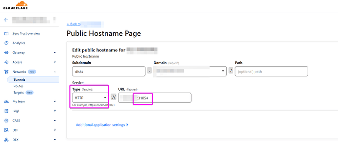

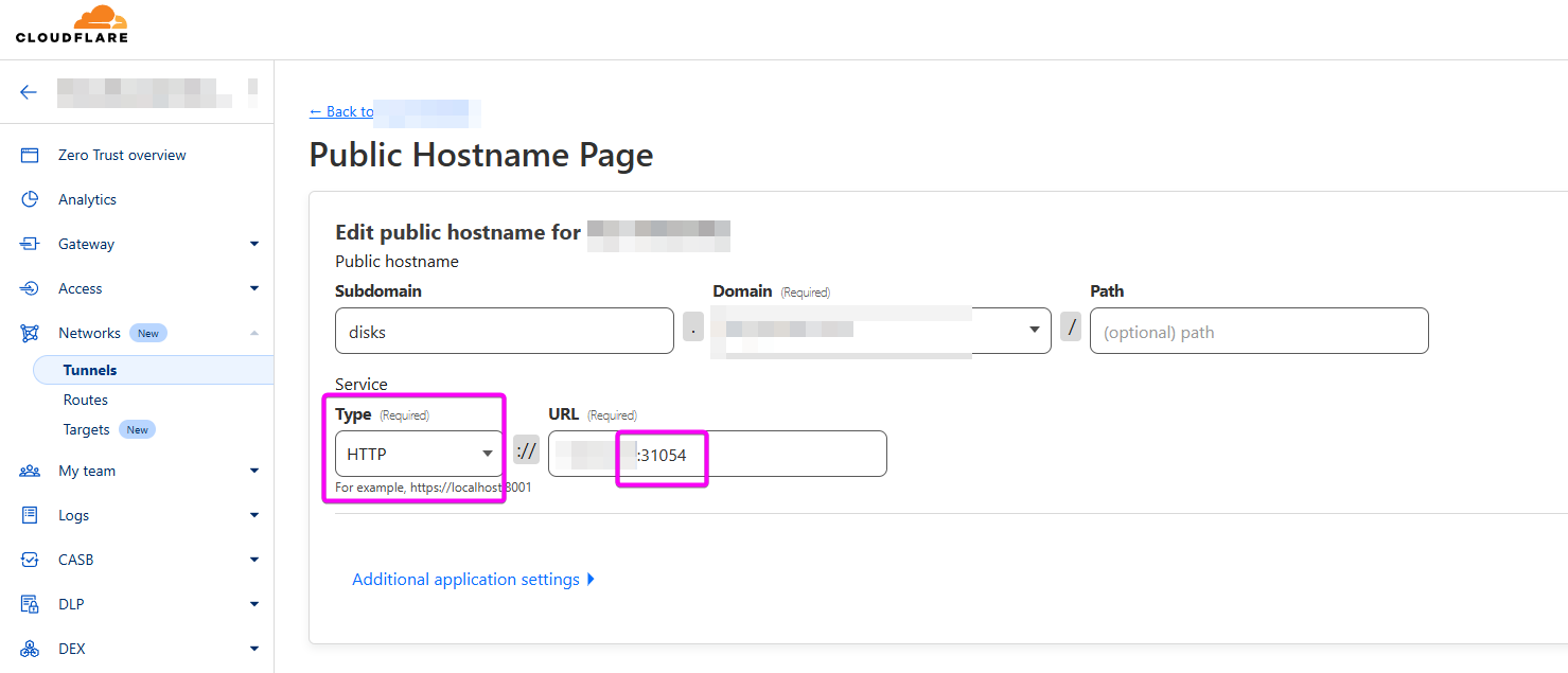

I use the Cloudflared app and can redirect into applications without an addon, assuming you can reach Home Assistant locally via a port should connect fine via Cloudflare Tunnel
For Example the Settings I have for one application are:
Make sure you set the HTTP or HTTPS type, and add the port to the end of your IP on URL.
