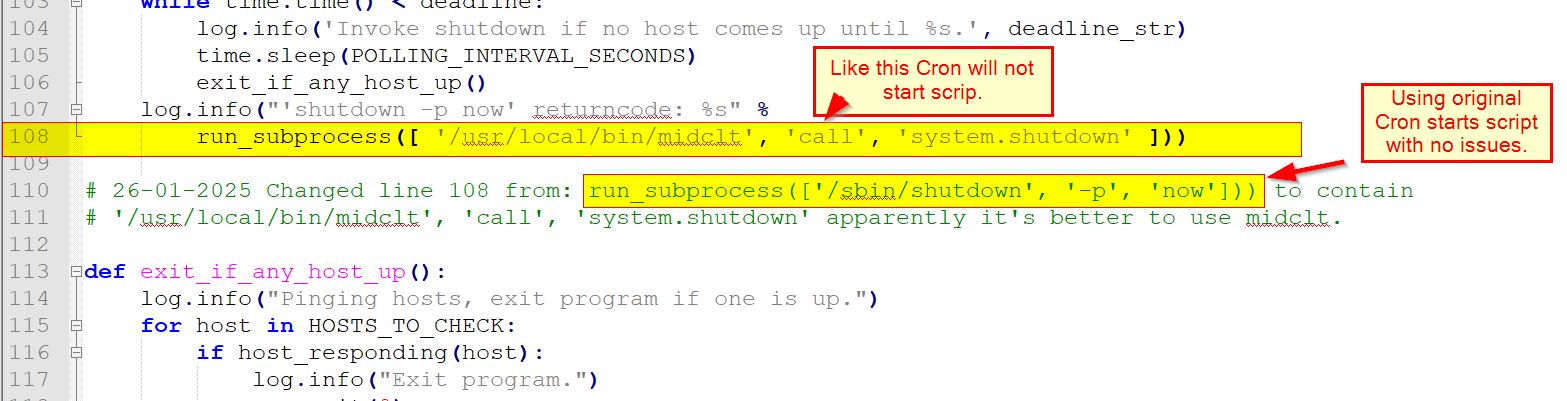

I have a shutdown script used for over 10 years with no issues and have read that using midclt is better so I changed line 108 on the script. Script works, but now Cron will not start the script, even after reboot. Cron job is set to run the script every 11 minutes.
With midclt changes:
1-Cron will not start script.
2-Manual start of the script via Cron with ‘Run Now’ runs and TN shuts down.
3-Manual start of the script via console runs and TN shuts down.
If I replace the line 108 back to original, Cron will run the script and PC will shut down as normal.
If It runs manually why can’t Cron start it after the change to midclt?

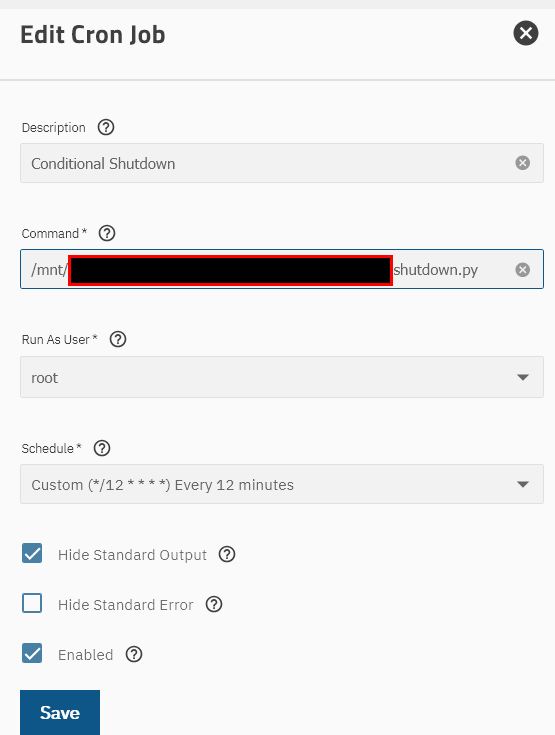

The image below is how I have it setup in Cron, not including the time interval in the script:

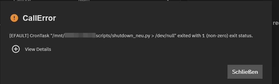

i had copied your Script Content, but it didnt work. It give every Time the Same Error, when i want to run the Script in GUI:

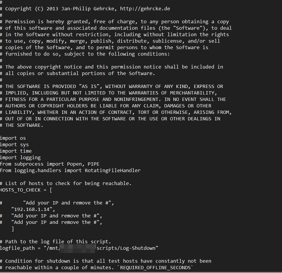

This ist the Script Content:

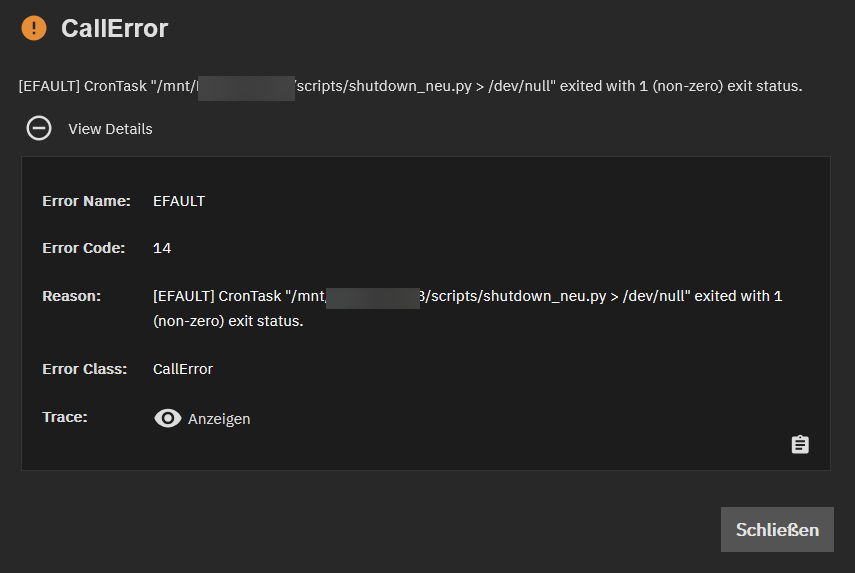

The Error also cames in my Script after Migrating to Scale. Dont know what Error Code 14 means. Root can reach and execute the Script without Problems over SSH.
I would glad to be, if you could help me. That the NAS cant automaticly shutdown sucks. Currently i only can use, shutdown at Midnight daily.

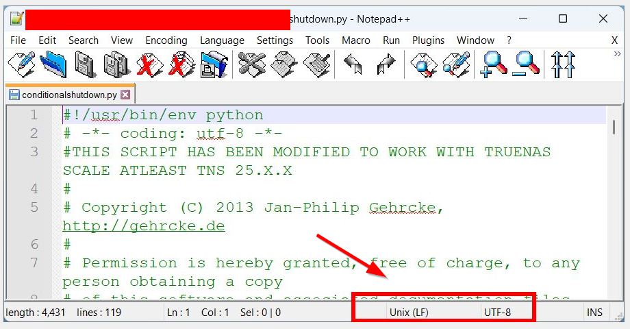

**It also just occurred to me an issue I had a million years ago though I don’t know if it applies to Python files, anyway, When I save Linux files I save them using Unix (LF) for end of line for if using Windows end of line CR (LF) it can cause errors if I remember correctly .

The Script with your Code works now fine on my Scale. I had Only forgot “log.log” in Path for Logfile.
Thnx for you help, you are my Hero.
