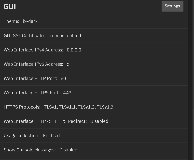

  2. In your truenas, go to System → General Settings (or just open https://192.168.1.124/ui/system/general) and make the screenshot of the GUI section.
For one, here is my screenshot
Thank you for your response @swc-phil
1 in my browser credentials all my servers url start with http
2 here is my screenshot

One of the possible solutions is to change them to https (or mb just add another applicable url; it really depends on credential manager implementation).
That’s odd. Your http → https redirection is already disabled. Mb it’s worth trying to turn it on and then off.
