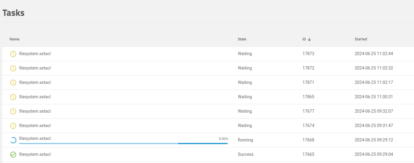

It is a holding 1.2million of images (and it will hold 80million in total) on a RAIDZ2 HDDs dataset (4x20Tb disks).
This morning I modified the ACLs in order to give permissions to a user.
Without realizing it would be veeery slow, I starting to test an nfs share poiting to that folder and because it didnt work because permissions I went again to modify the ACL to figure out what I had to adjust to make it work.

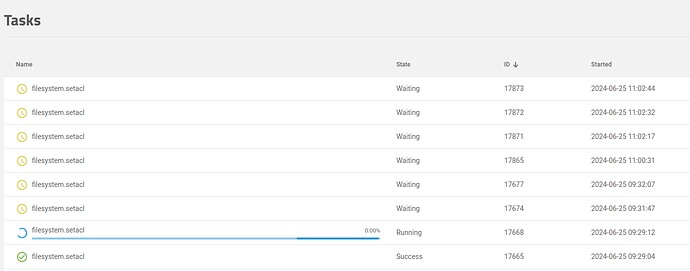

Now I see there are bunch of tasks pending. I started to change ACLs at 9.30am,
now it is 11.45 and still running. As you can see there are still bunch of setacl pending and it will take forever.
There is anyway to stop the runing and pending tasks filsystem.setacl?

I would like to know if there is any way to remove them from the task queue.
I understand it is slow because a matter of IOPS, but since the number of recursive setacls queued is significant. Still not finished since this morning.
It is also synchronous, so until one setfacl task does not finishes another can not start.
