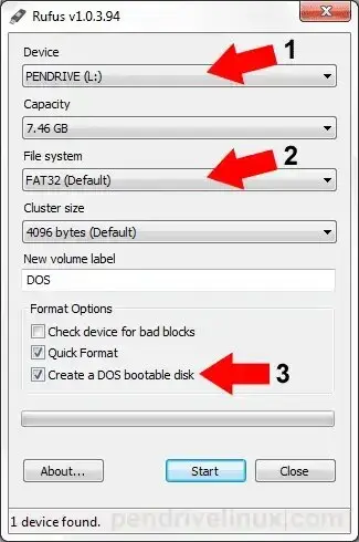

You should be able to put the USB drive in your Windows machine, start Rufus, then pick “FreeDOS” somewhere in Rufus and format the drive. No need to download FreeDOS or anything else but Rufus.
Refer to the Rufus documentation or use a search engine, please - I don’t have Windows and Rufus available right now.
Should find something like this which looks pretty reasonable:
You need to format with MBR, FAT32, select FreeDOS, then in your system’s BIOS enable legacy boot if that is not the case already.
