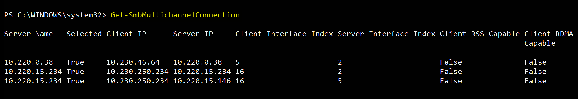

I tested SMB Multichannel Connection on other Windows servers that have multiple NICs on the same subnet and I see multichannel connection in between other client/server hosts, just not SCALE.
I’m not sure whether SCALE will complain if I enabled SMB Multichannel in this configuration, or if I will inadvertently break something.
