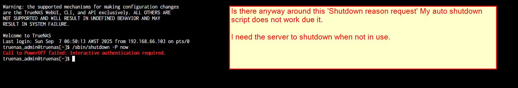

Just encountered this ‘Reason when shutting down’ as such my shut down script does not work Is there anyway around it. I don’t need my server running 24/7 for no reason so it auto shuts down when not in use. At least it does with TN Core.
This is one horrible feature. Even trying to shut it down from putty it wants a reason. Interactive authentication required.
No, it wants you to authenticate, just like it says. truenas_admin doesn’t have rights to power off the server; that would need to be root.

Yes, and it’s a command that only root has permission to run. truenas_admin is not root, but can gain root permissions using sudo.
What script? And how are you running it? If it’s a cron job, that goes back to what I said earlier: run the script as root.

To the question that’s the subject of this thread, once again, the command you’re using, if run as root, works just fine to shut down the server. A better command would be using the API as was previously noted up-thread: midclt call system.shutdown "whatever"–which can be run as the admin user.

In any case, why the shut down script did not work is during setup I was test initiating from the shell to see for any errors but all I got was the authentication request making me believe I would need it when I use Cron, but once I set up Cron and used root it worked without issue. Confusion on my part, I should have just run it straight through cron without testing the script still works.
It’s done. Shuts down when no listed IP’s present all on its own.
Thanks for the help to all. I will try that midclt if I ever get to finish the rest.
Replaced </sbin/shutdown -P now> with < /usr/bin/midclt call system.shutdown now > in the script and all still works. That’s done.
