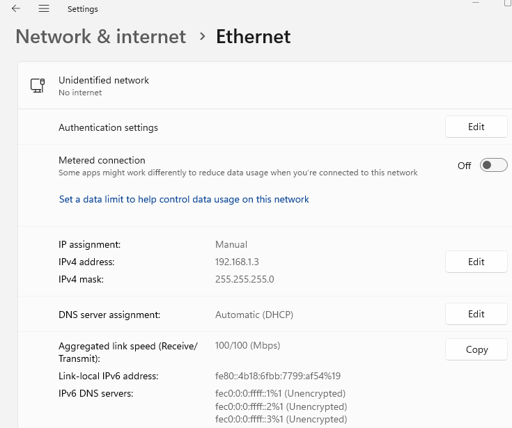

Next, I was trying ssh from linux laptop to my windows laptop. During this process, I changed the DHCP mode to manual mode IP address on my windows laptop.
After this change, I tried SSH from True NAS core to windows laptop, it is working fine.
Any idea behind this, why SSH does not work for DHCP mode??
