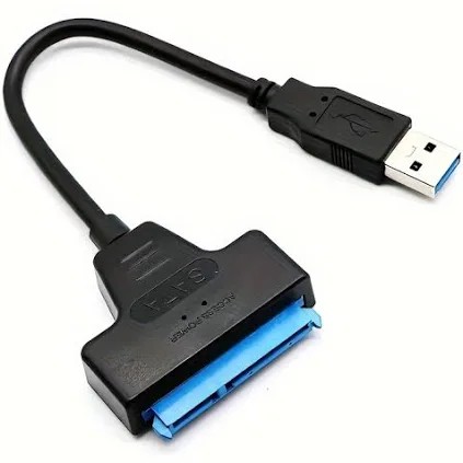

I was using an adapter without enclosure:
My mainboard Is equipped with an internal USB port, so the disk was placed internally and benefited of the airflow.
