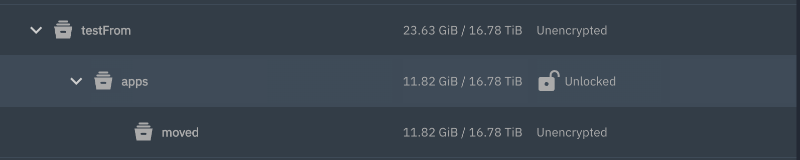

I setup a test case for the first idea to check if the ‘zfs rename’ function is working fine with unencrypted dataset to an encrypted dataset. After trying it out, it seems like its working fine, the only thing which is different is that the child dataset (the renamed original one) is not encrypted, but the parent dataset is. The result can be seen here. I am not sure if this is fine…

That won’t encrypt an unencrypted dataset. The rename command does not change or touch any dataset properties.

The dataset is still unencrypted. See my first comment.

Encryption is per dataset. If a parent is encrypted, but a child is not, then yes, the files on the child dataset are easily accessible. With any Linux box, you can independently “mount” the child dataset without needing to unlock its parent.
The only relation encrypted children have to their parents is if they share a common “encryptionroot”, which allows them to be unlocked together with the same key/passphrase, seamlessly.
As for “it’s not allowed”, that’s a TrueNAS policy. The middleware tries to prevent you from doing this. Since you used the zfs rename command, you bypass the middleware. Otherwise, TrueNAS would not allow it.
