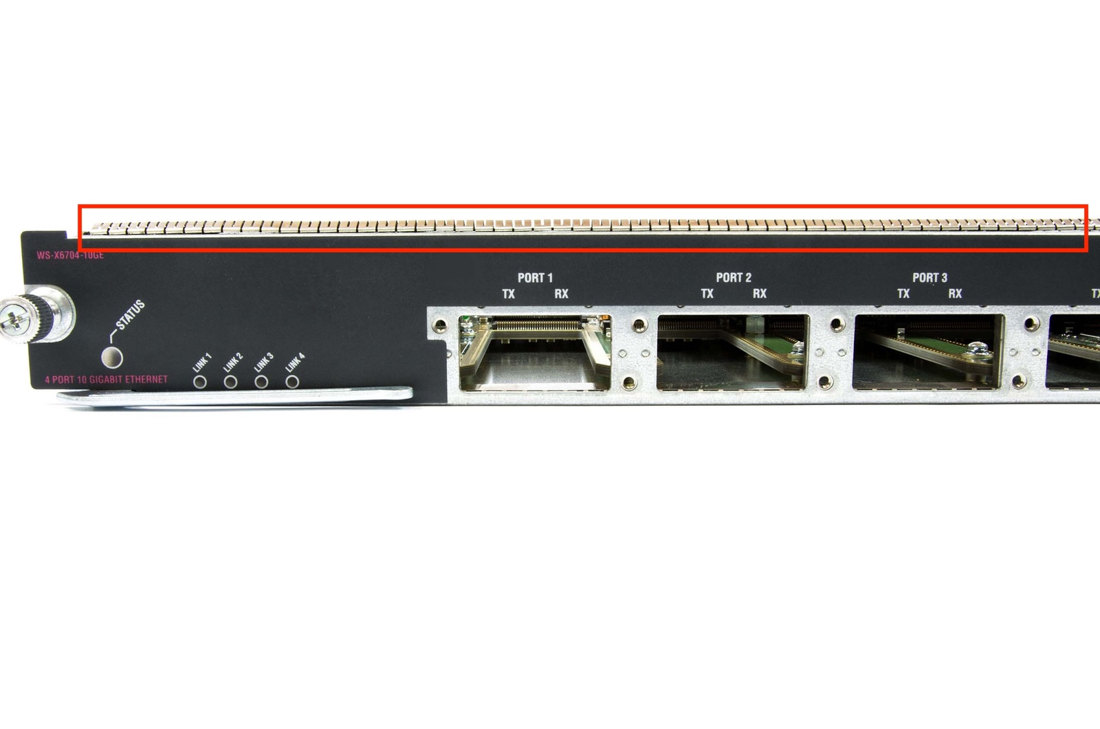

Allow me to quibble re: computer cases being effective Faraday cages. For certain wavelengths that may be true but it will depend a lot on the construction of the case. Ie.
  • Is it metal?
  • if it’s metal, has been grounded properly?
  • Does it have fan inlets / outlets, plastic covers for hot swap bays, glass windows to admire your build, etc. that are electromagnetically transparent ?
    Etc.
    Most cases are not in fact perfect Faraday cages. Never mind all the connections going in and out of the case allowing the transmission of waves into the case.
Have you ever seen the beryllium copper seals on the hatches to the command center of a navy ship? They mean business for a reason. What frequencies can be kept out depends a lot on the hole size, intensity of the radiation, speed of the object, etc.
Cosmic rays need several inches of lead shielding to be kept out. Neutrinos caused by cosmic rays are detectable miles underground. Even the cray 1 with its much older, larger modules experienced bit flips.
