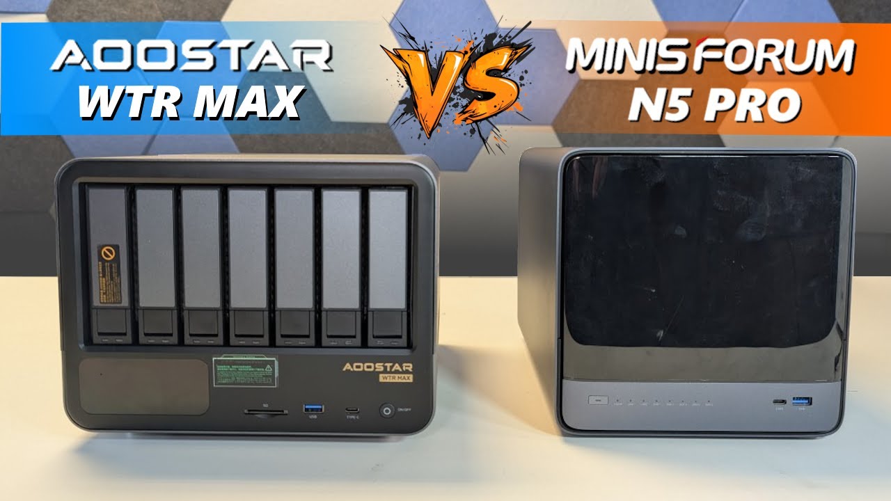

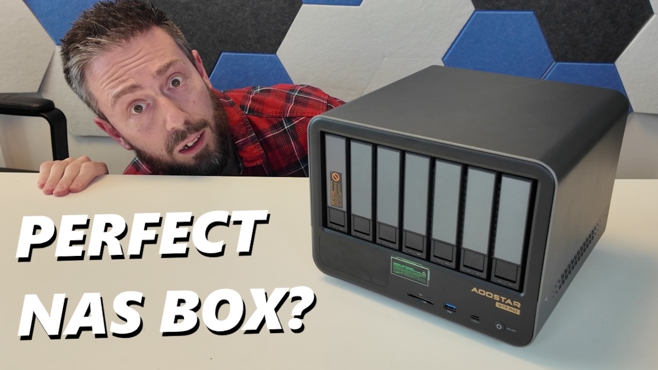

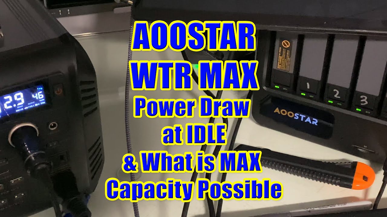

Thought I’d come back and update this since it got bumped but I did not end up going with the Aoostar WTR Max for my build and instead built my own. Ended up being a bigger form factor than I originally wanted but I’ll live with it. Gives me room to add more drives later down the line.
Also the Youtube channel NASCompares has done videos on both this NAS and the Minisforum N5 Pro if anyone is interested in these machines for use with TrueNAS:
