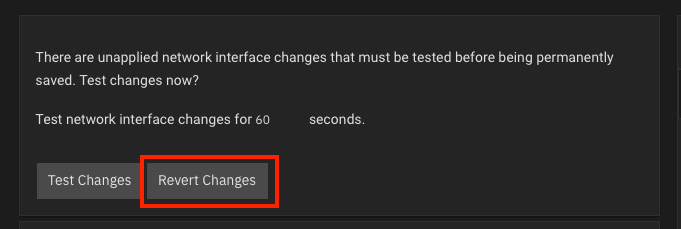

  4. When back in the main network section, you’ll notice a prompt to test changes - click on Revert Changes. I don’t know why, but this will cause the device to obtain a link local IPv6 address that you should now see listed (perhaps it restart the network service?) image

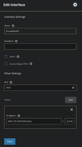

One additional note: to make the connection to the Mac as easy as possible, I’ve made the TrueNAS self-assigned IPv6 address on the interface static with a /128 prefix like so:
This allows me to store the ip + credentials on the Mac such that each time the server is rebooted, I just need to hit Cmd + K and Enter in Finder and it’ll reconnect with my stored credentials automatically.
