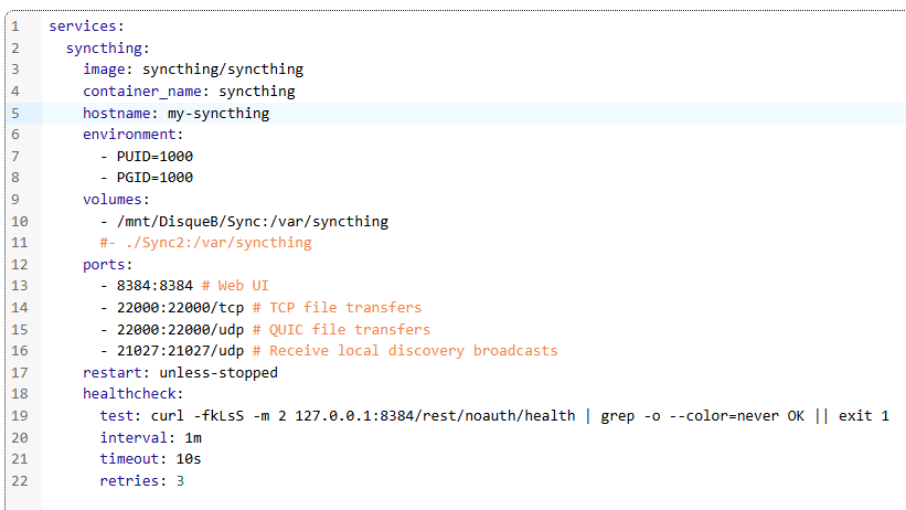

Good morning,
I’m not an ACL pro.
I successfully installed Syncthing with Docker Compose, here is my .yml file :
The volume /mnt/DisqueB/Sync is an SMB share.
Sync is a Dataset of DisqueB :
In Truenas user 1000 is not defined in the credentials.
Here are the ACLs of /mnt/DisqueB/Sync :
In Windows 11 I can see the Sync directory and I can browse it.
I’m not sure my configuration is secure but it works perfectly. I successfully synchronize photos and videos from two Smartphones and Truenas Sync SMB share.
If this helps…
Questions are welcome…
