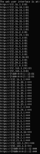

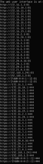

I know I can set web ui to bind only to the external IP, but I want to have webui available on localhost for local, non-internet facing reverse proxy.
Yeah, Iām not seeing that. I also donāt have apps enabled and am using Incus aka Instances. Those are all your Docker networks.
netstat -lnp -t nat|grep -E '80|443'
tcp 0 0 0.0.0.0:443 0.0.0.0:* LISTEN 3592/nginx: master
tcp 0 0 0.0.0.0:80 0.0.0.0:* LISTEN 3592/nginx: master
tcp6 0 0 :::443 :::* LISTEN 3592/nginx: master
tcp6 0 0 :::80 :::* LISTEN 3592/nginx: master
You can go into: System > General then adjust the Web Interface settings to only listen on specific interfaces.
My bet is this is a fail-safe setting for out of the box until you get your TNCE box setup and configured, then you would scope it down to the management interface you want to use for the Web UI.
It would have been nice if you could add manual entities to that Web Interface field instead of choosing between broadcasting to everything or just hostās IP.
Nevertheless, there should be at least some warning, itās easy to overlook this security issue when setting up a public facing reverse proxy.

At least scope it to system interfaces and ignore docker interfaces by default.
Wouldnāt not listening on Docker interfaces prevent reverse proxies running in Docker from proxying TrueNAS? (Thatās how I get HTTPS for my TrueNAS servers, since Iāve got the reverse proxies running anyway, and itās easier to have all my cert acquisition in one place.)
Iām referencing the Web Interface only listening on system interfaces, not Docker, Incus, etc.
Yes, sorry. What Iām saying is that if the TrueNAS Web UI didnāt listen on Docker interfaces, then it wouldnāt that cause issues for Docker reverse proxies that should reach the Web interface?
For example, I run a Caddy version proxy on ports 80 and 443. I moved the TrueNAS Web UI āout of the wayā to ports 8080 and 8443, and I configured Caddy to proxy my TrueNAS subdomain to host.docker.internal:8080. But, unless Iām just misunderstanding you, that wouldnāt work with the setup youāre proposing, since TrueNAS would no longer be listening on the relevant Docker interface.

I think if you setup a bridge interface, you shouldnāt have issues.
