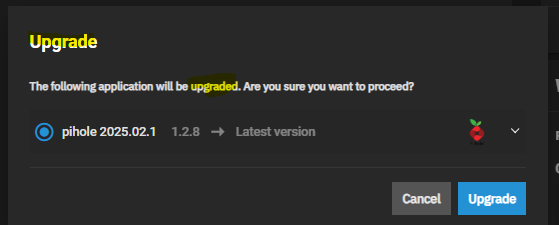

Admittedly a really minor thing, but in 24.10.2, when Apps are “Updated” the button to compete this task requests user to “Upgrade”. That is, “Update All” in the Apps section results in a pop-up confirmation UI requesting if the user wants to “Upgrade” a given App. I know its minor, but Upgrade and Update aren’t the same thing, has this changed in 25?

There is a ticket in the backlog to address this, but it is not currently changed in RC.1.

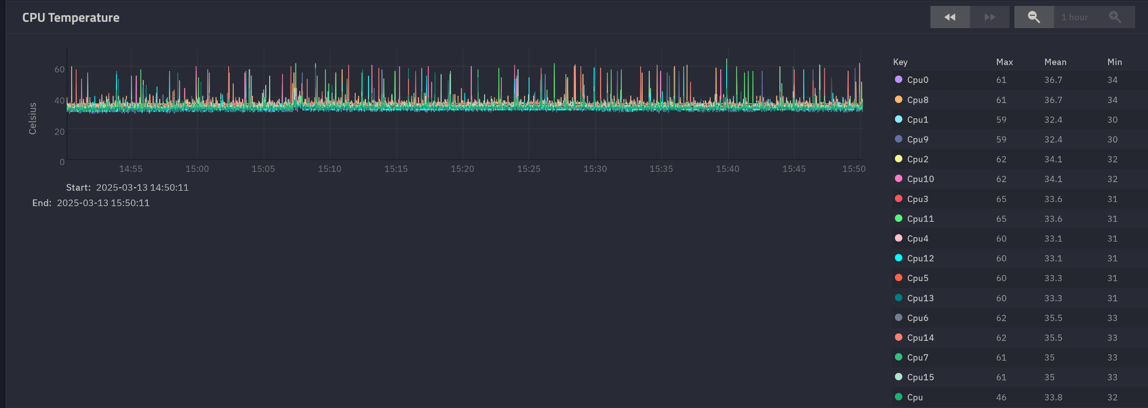

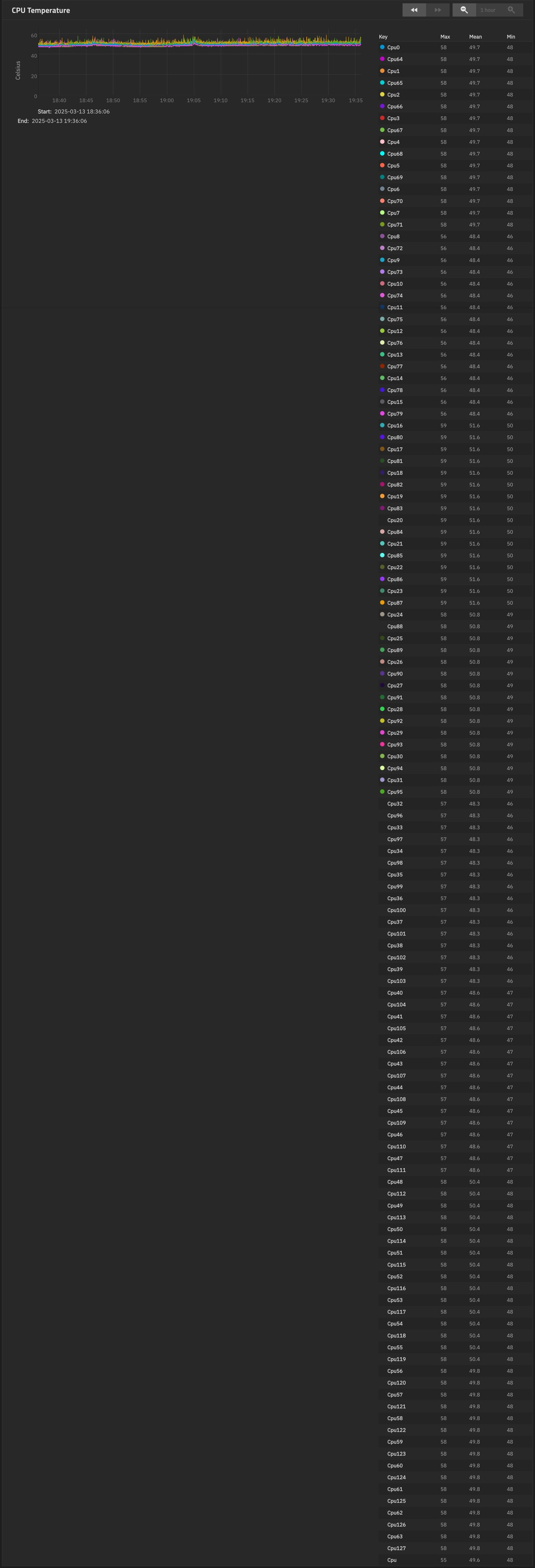

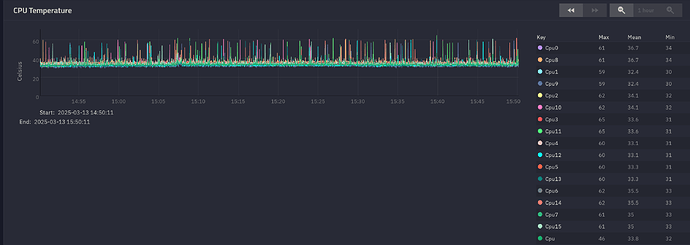

The CPU temperature graph is per-thread? And is Cpu supposed to represent the CPU Package? Also seems like a lot of lost space.

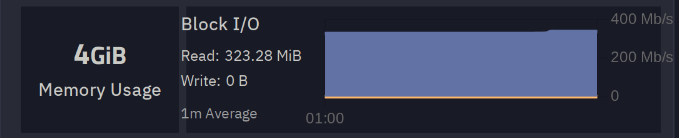

The Apps Block I/O dashboard panel graph seems to be cumulative instead of representative of current / sampled values. Seems weird to use a graph for this if it’s cumulative.
I believe it’s been this way for a while and not really ‘important’ to me, but I can’t see per-thread being useful. Not sure if there’s an easy to way to only show core temps. The results of it do amuse me, though:
Again, amusement purposes only :slight_smile:
I was wondering what the additional CPU was. I think you’re right that it’s the overall CPU temp.
