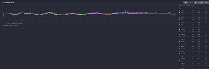

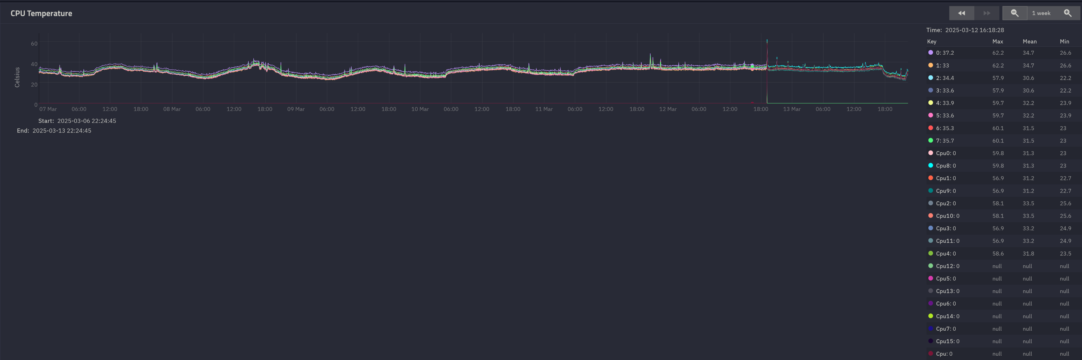

Have only been seeing this since the update from BETA->RC myself, so no idea when it was introduced if you have been seeing it for a while.
PSA: remember to refresh your browser cache after TrueNAS updates.
