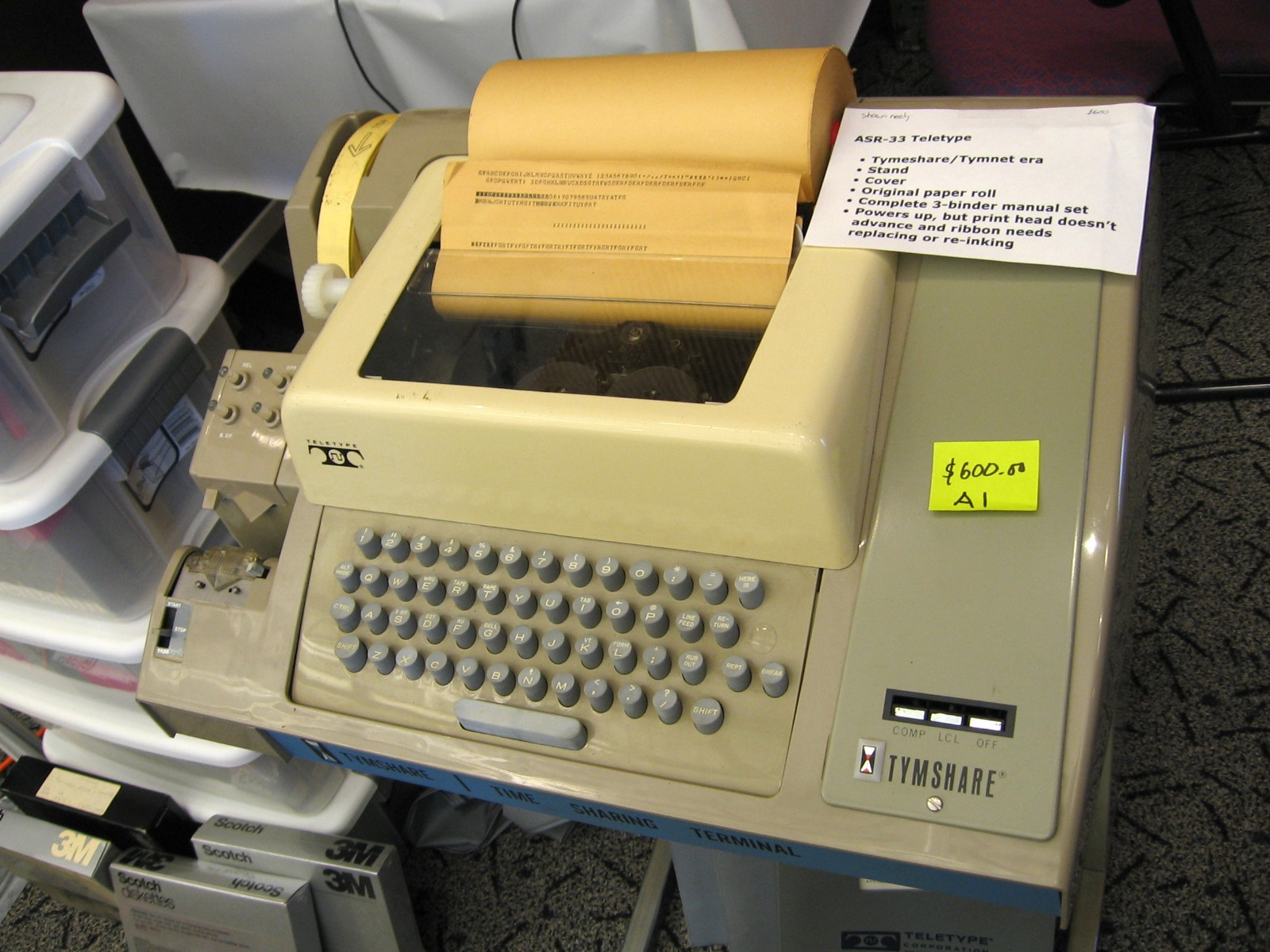

AFAIK, the motherboard’s beep is just an ASCII character.
OMG, the bell character reminds me of when I was in high school when the bell character actually rang a bell on a TTY. Brings back some fond memories.
This is probably not the exact model but it is close. The one I used didn’t have a paper tape reader/punch.
