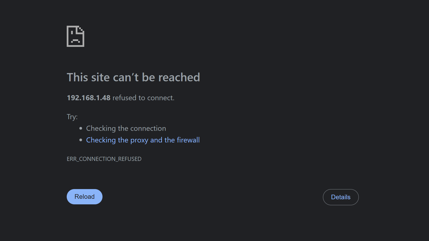

Whenever I try to access to gui via LAN: 192.168.1.48:(port) it just gives me a dead screen.

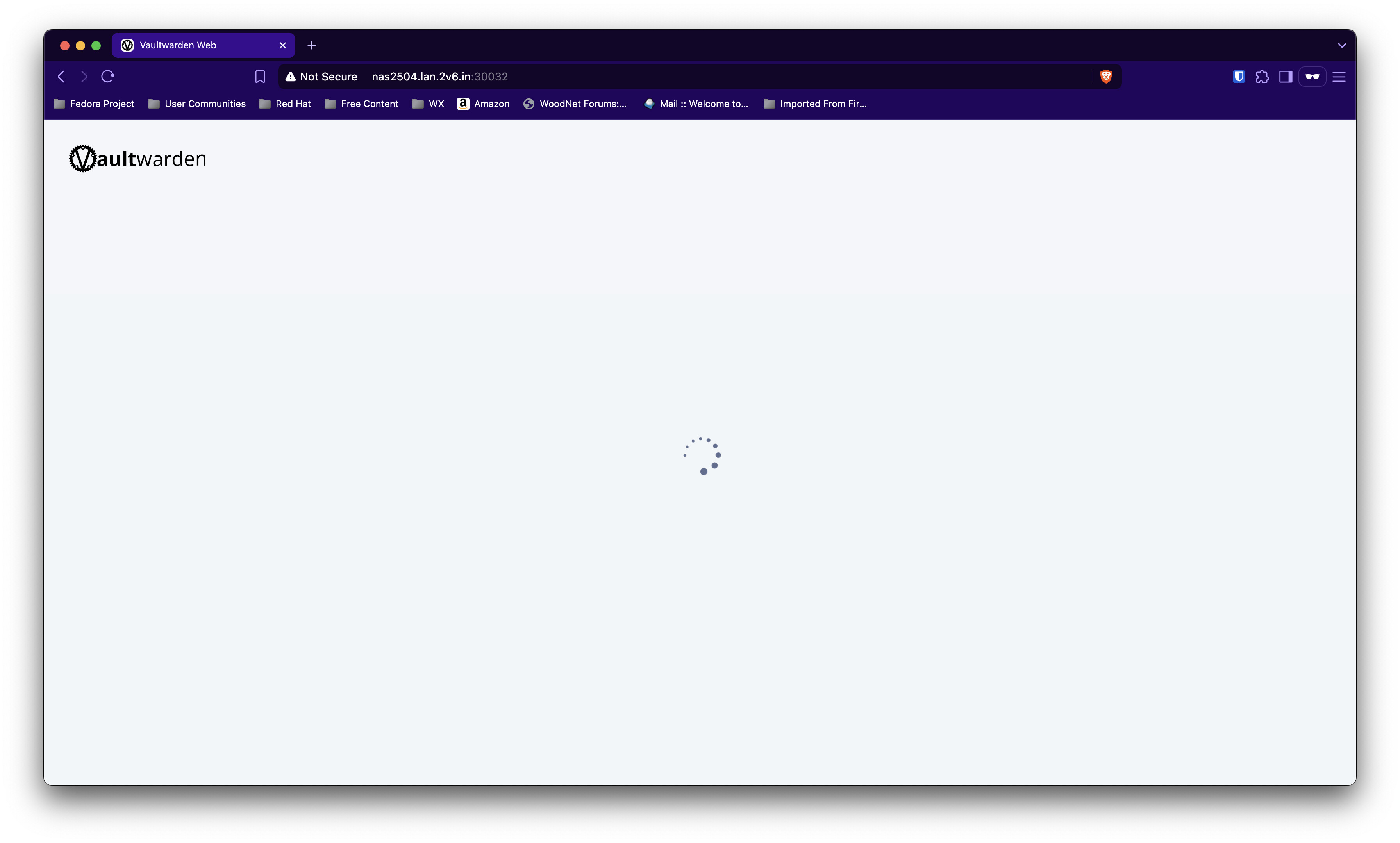

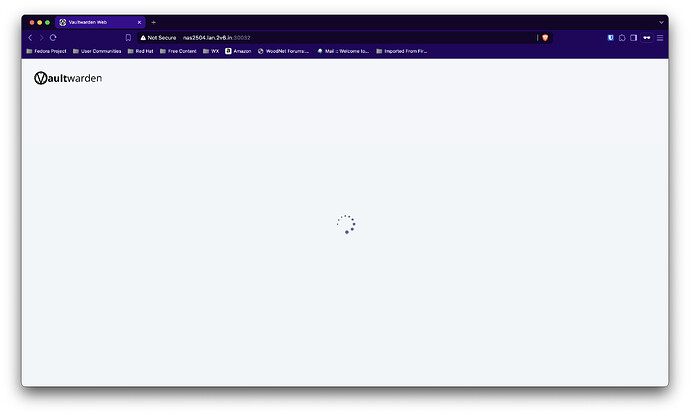

Just installed the app with completely stock settings, entering a database password and an admin token (both generated using pwgen -s 50 2, though I doubt that matters). No other changes. Here’s what I get:

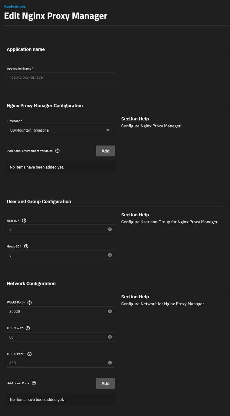

One: For installing nginx you NEED to use the ix-applications storage option when installing it as an app. Using any kind of host storage option does not work correctly. The helpful video says this “that it does not load” but in my case it loaded and did not actually work correctly. https://www.youtube.com/watch?v=_FcC79zMiJc
Two: Following this super helpful guide TrueNAS Scale Reverse Proxy with Nginx and DuckDNS - DeveloperJose @DeveloperJose Thank you so much. I realized that my nginx ports were not correct at the correct 80, 443. I changed them because it conflicted with the Truenas GUI ports, but the right way was to keep nginx at the default values and change the Truenas GUI (81/444). My dumbass didn’t realize the whole system rests on the proxy working on these ports and I did it backwards by changing the nginx ports.

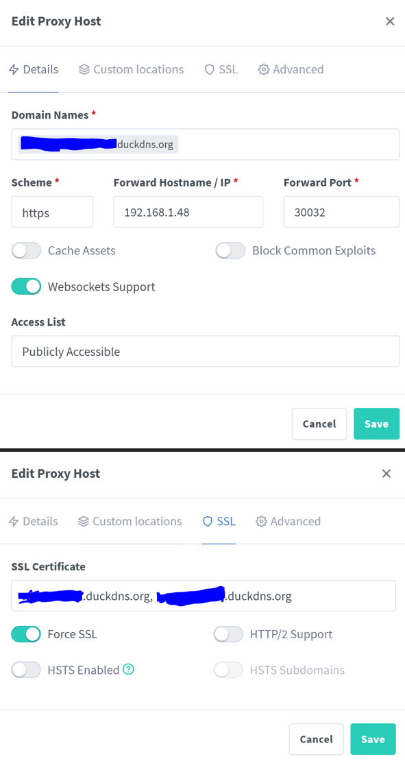

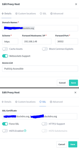

Three: Just trial and error and I realized the nginx proxy host settings needed to be the following. It differed from the how-to from Jose, and I can’t explain why. But it works for all my apps for me. YMMV:
Finally got this working, although a lot of this was not intuitive. Thought I would post this to steer this to Jose’s helpful how-to.

This suggests that you had incorrect permissions when you tried the host path volume.
Thats probably it. The dataset from my hosts path was owned by the same group for all the other apps that get access no problem. In either event, I am happy it works.
Just to rule it out I tried it from scratch again with host volumes. No matter what ownership you give the host dataset (root, apps, everyone, etc.) it still will not load at all. I treid them all.
The ix default one works, so the guy in the video probably tried it. Its not a big deal at all, but something happens with host volumes that doesn’t happen with ix-applications during the install to break it for me.
Problem is solved, just posting this here for posterity.
Something happens with ix-volumes that doesn’t happen with host volumes–namely that they are automatically created with the correct permissions.
I just test installed with ix-volumes and the permissions on the created datasets were
drwxr-xr-x 2 apps apps 2 May  1 13:05 certs
drwxr-xr-x 7 apps apps 7 May  1 13:06 data
So I created two host path datasets and gave apps:apps full control. Then I deployed with my host path datasets.
It took a long time for NPM to set permissions, but that’s expected for apps that chown everything on boot. It’s up and running now
