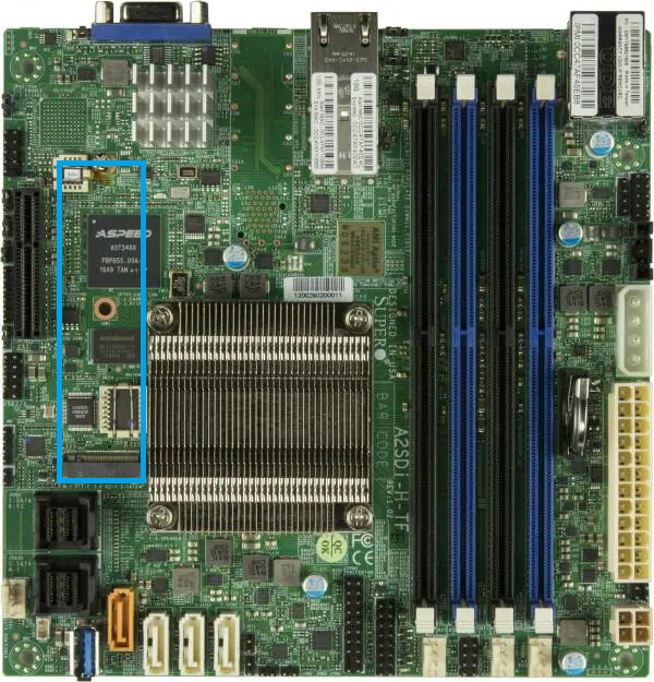

Hey @tim64
Can you show me the output of dmidecode | grep "Base Board Information" -A3 from your console? This should let me know the exact board model and revision in your Mini, and then I can hopefully give you a definitive answer as to what your options are.
Our newer X+ and R units have an M.2 NVMe boot device, but an older unit might not have that as an option.

The Output is:
        Manufacturer: Supermicro
        Product Name: A2SDi-H-TF
        Version: 1.10
Thank you very much.
If I am not mistaken, the SSD is plugged into the I-SATA0 socket of the mainboard.
Thanks a lot.
You should have an M.2 2280 socket on your board that can be populated with an NVMe device and used for boot purposes.
