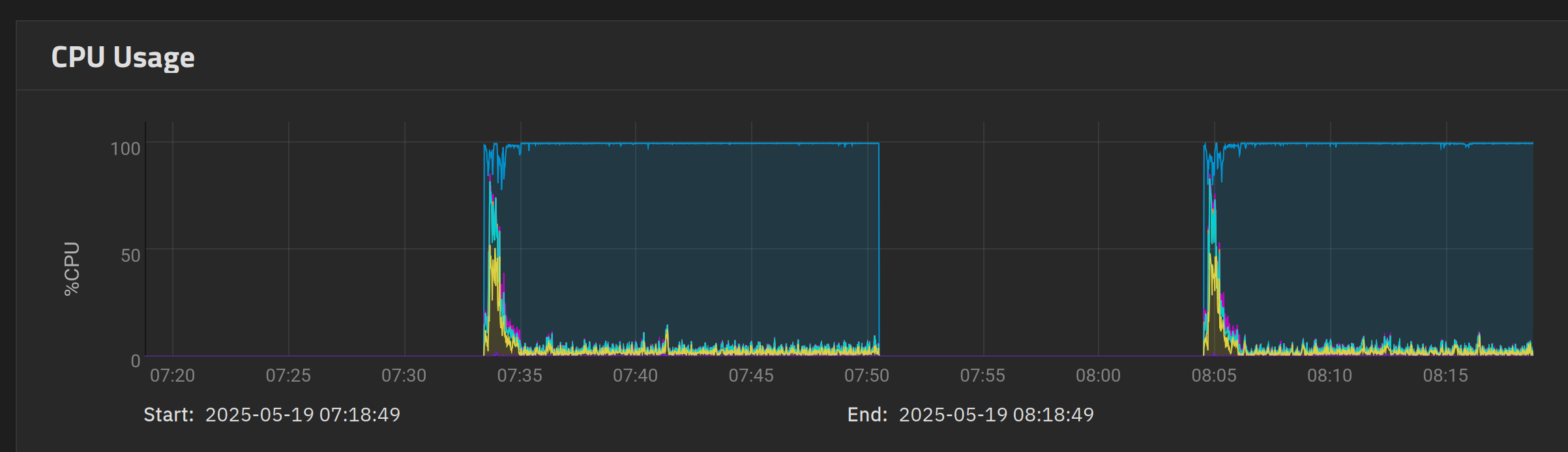

I’ve been tied up with home repair projects and am not sure how long this has been going on, but I noticed today that my machine is turning off and rebooting every 30 minutes or so.
I’d appreciate any advice on what to look at first to diagnose what’s going on and troubleshoot it.

Since it appears you can see when the system is rebooting, examine that graph report to see when these started and then think back as to if anything physical or software changes occured. Maybe you moved it or installed some software or reconfigured the system.

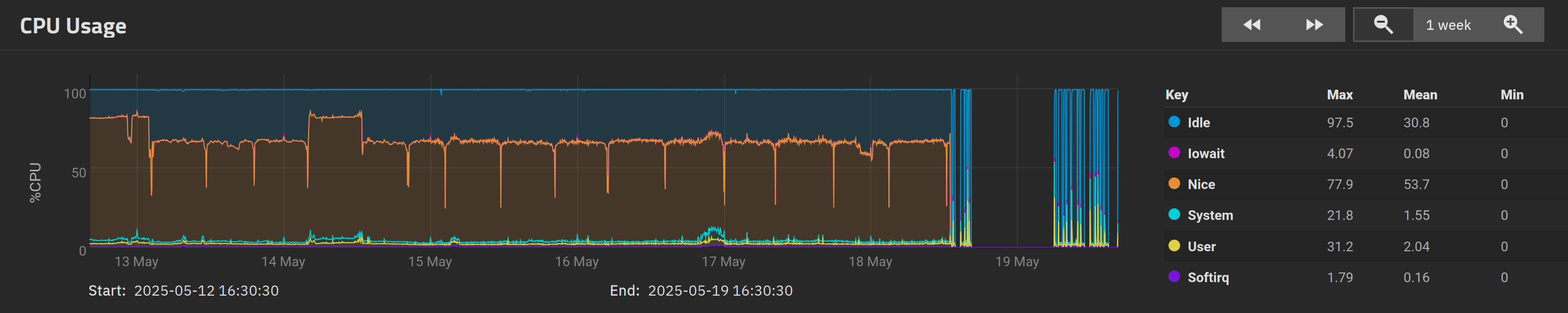

Zooming out to a week shows that this rebooting loop only began about a day ago. There wasn’t any change to the system that I can think of, and it’s been on this same circuit + UPS for 6 months now. The big gap is when I noticed the loop and turned it off overnight so I could sleep.

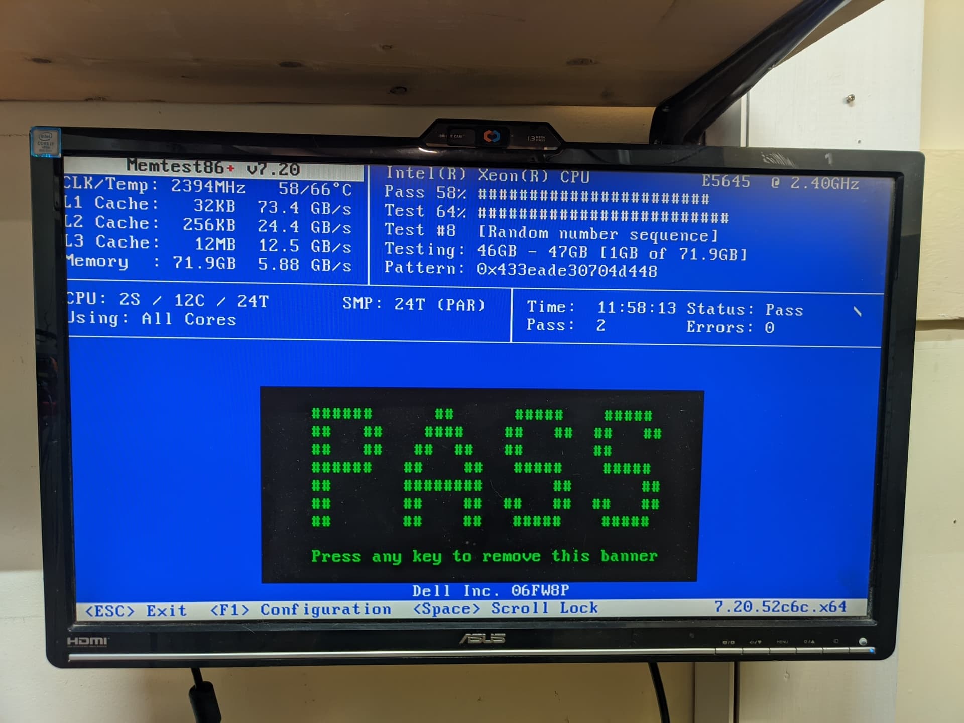

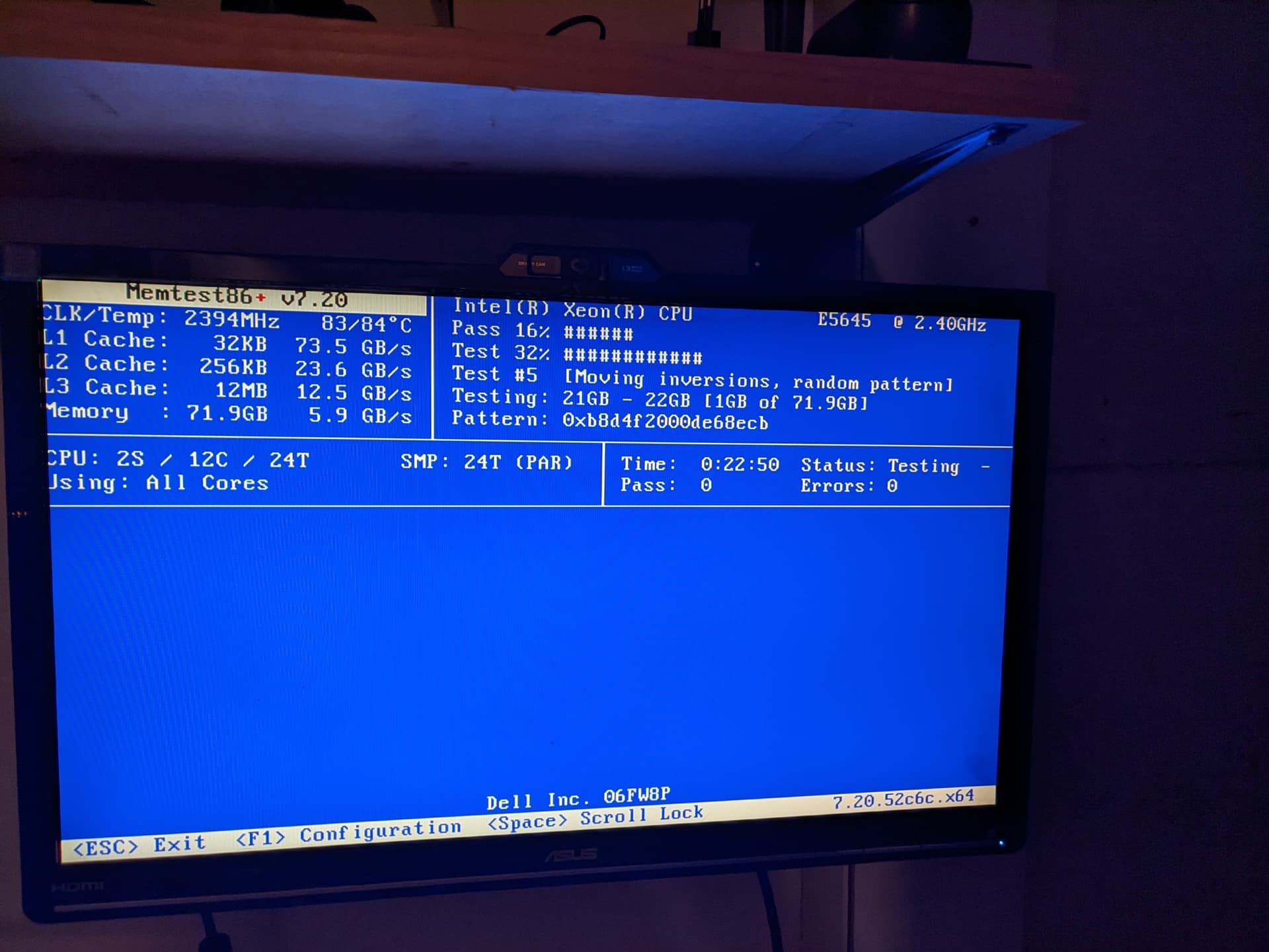

I moved the system to another area of the house to be near a monitor. Different circuit and UPS. Loaded up Memtest and the temperature immediately went pretty high:

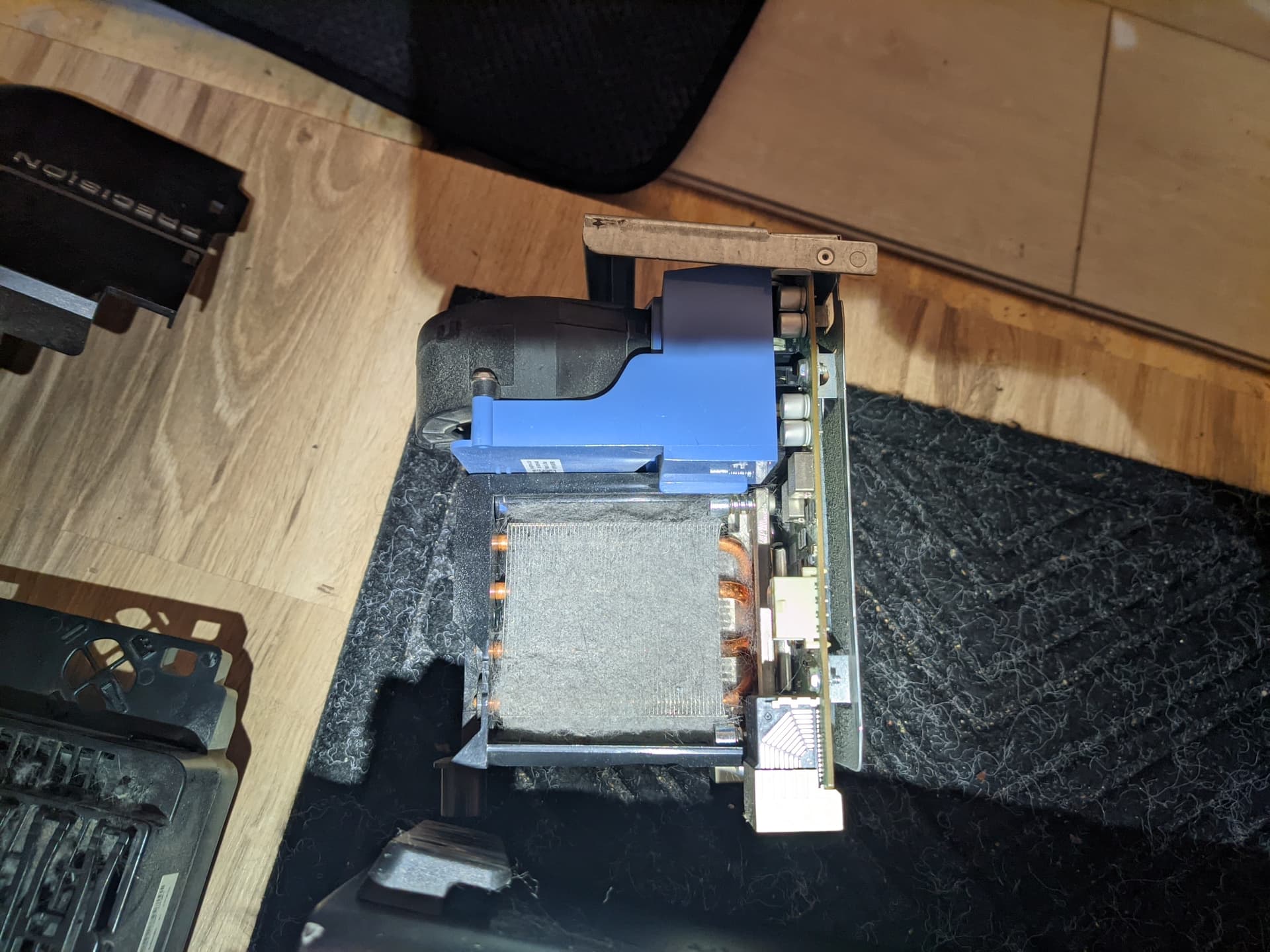

So I took things apart and discovered what I hoped was the culprit of the boot loops:
With the whole machine cleaned out of dust, Memtest ran 20 degrees cooler and finished:

OK, I perused the BIOS settings, reset them to defaults and reconfigured. I tried running the system in NUMA and then SMP since Memtest86 shows it uses SMP… Then I tried removing the network cable since the memory test was done without that plugged in. No dice. System consistently clunks off and reboots after about five minutes every time.

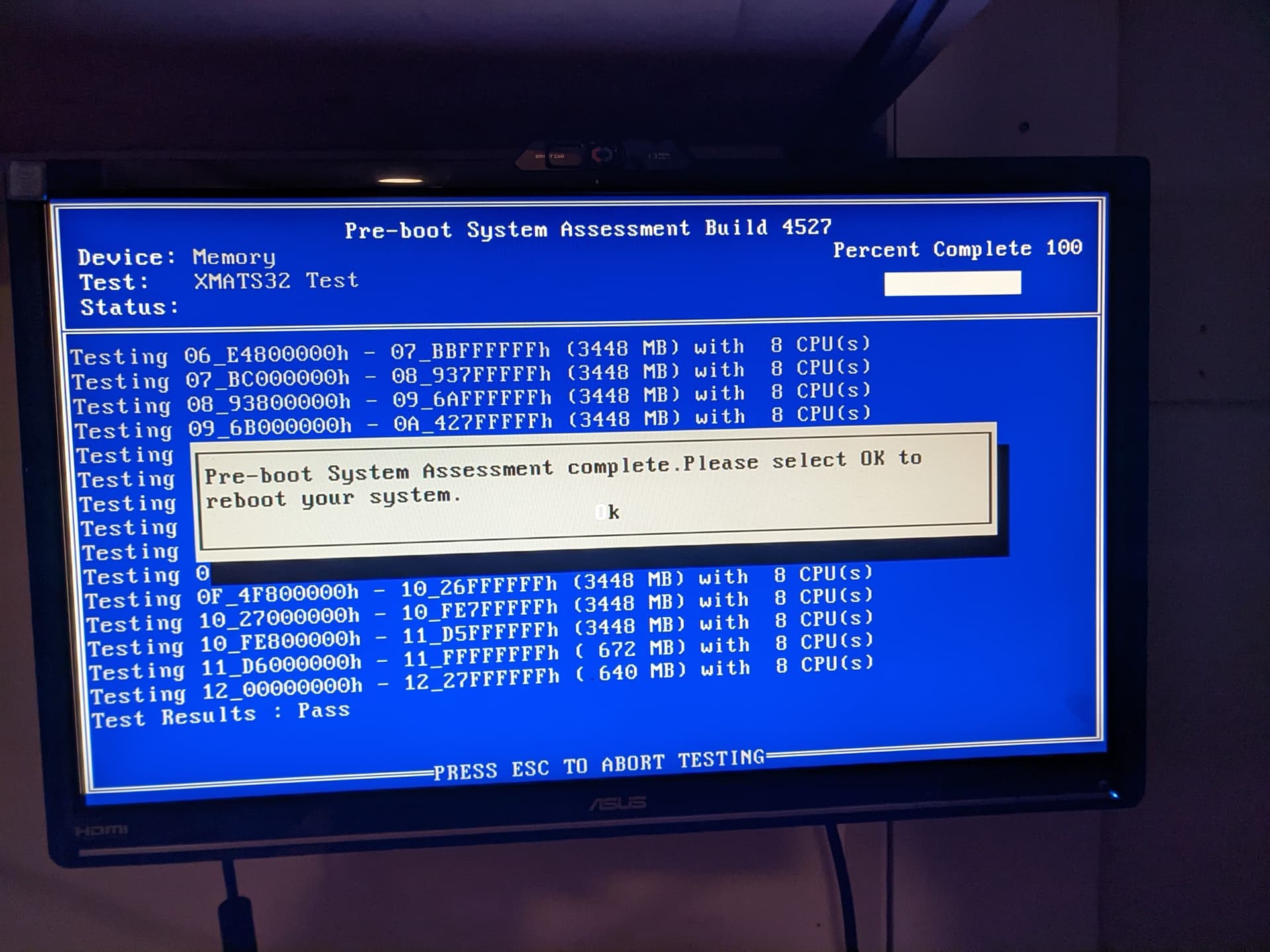

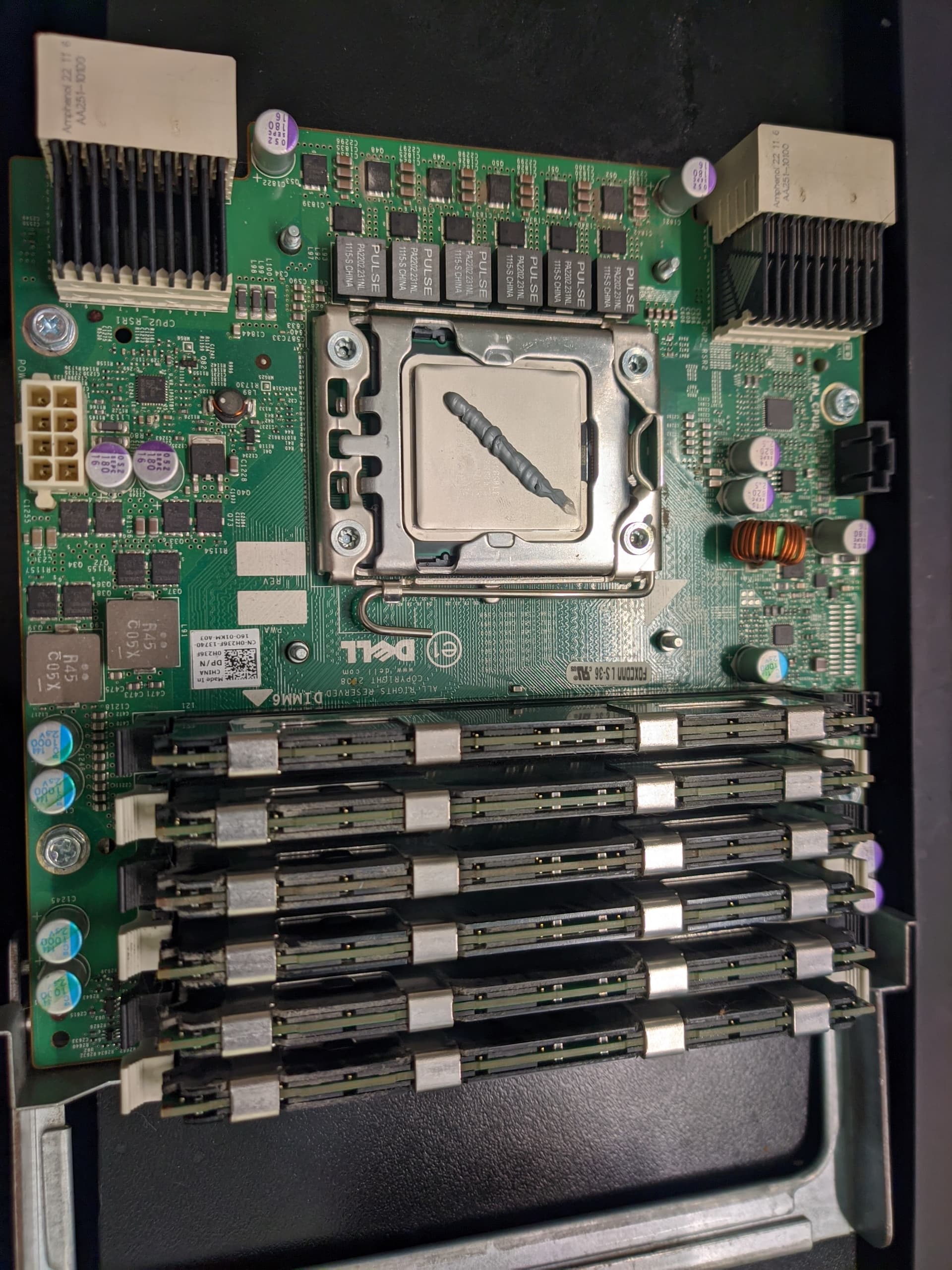

I took all of the heatsinks off and put new thermal paste down, just in case it helped. Then ran the built-in diagnostics, which took several hours and found no issues.
