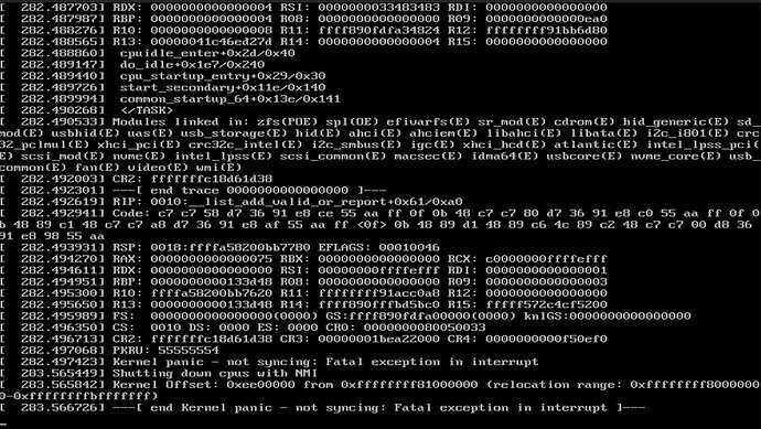

I’m experiencing daily crashes on my TrueNAS SCALE pretty much shortly after I installed it a few weeks ago. It’s running on UGreen DXP4800 Plus (Intel Pentium Gold 8505; 32GB DDR5; 100GB NVME boot disk; 2x 4TB NVME SSD; 4x 16TB Seagate X18 Exos).
I installed 25.04.1, then upgraded to 25.04.2, and then 25.04.2.1. All three versions experienced crashes.
Initially I was using 2x 32GB DDR5. I suspected it could be due to faulty RAM so I ran memtest and it failed quickly with many errors (I returned the RAM and the seller claims he ran memtests on it on a couple of his machines after it was returned and they passed, so it’s possible it was not seated properly in my NAS). Anyway, I swapped them out with 2x 16GB DDR5 and did memtest for a couple of hours with no errors after that but the crashes kept on happening still.
I’ve used a Live Finnix USB to run Long SMART tests on the boot SSD, 2x 4TB SSD. All passed the Long tests. I’ve also ran Long SMART tests on all the 16TB X18 Exos earlier when I first put them into TrueNAS – they also passed the tests.
The crashes happens after a couple of hours after I restart TrueNAS, usually there will be one within 24 hours. When the crashes was due to the faulty RAM, the system would just completely freeze with no additional output on the screen (the last image is the TrueNAS login/options page where it shows the system IP and numeric options to choose) and nothing strange in /var/log/messages.

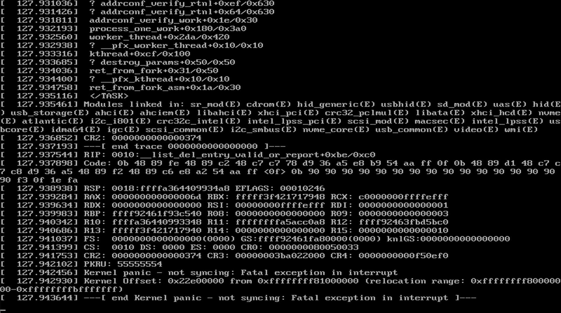

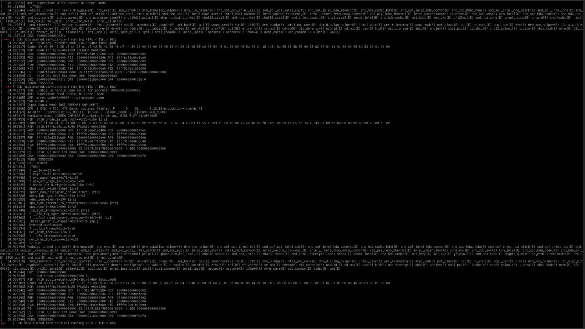

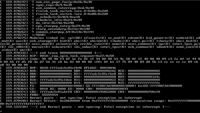

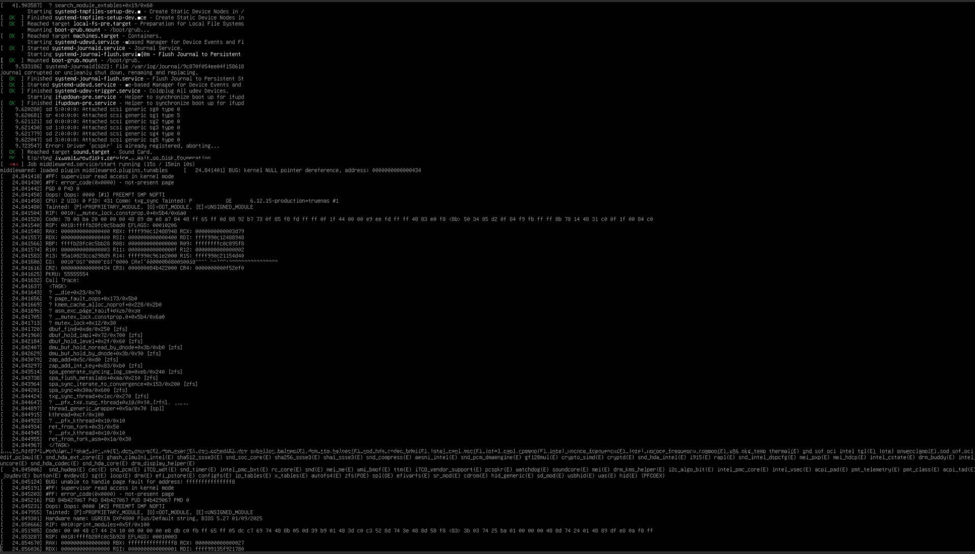

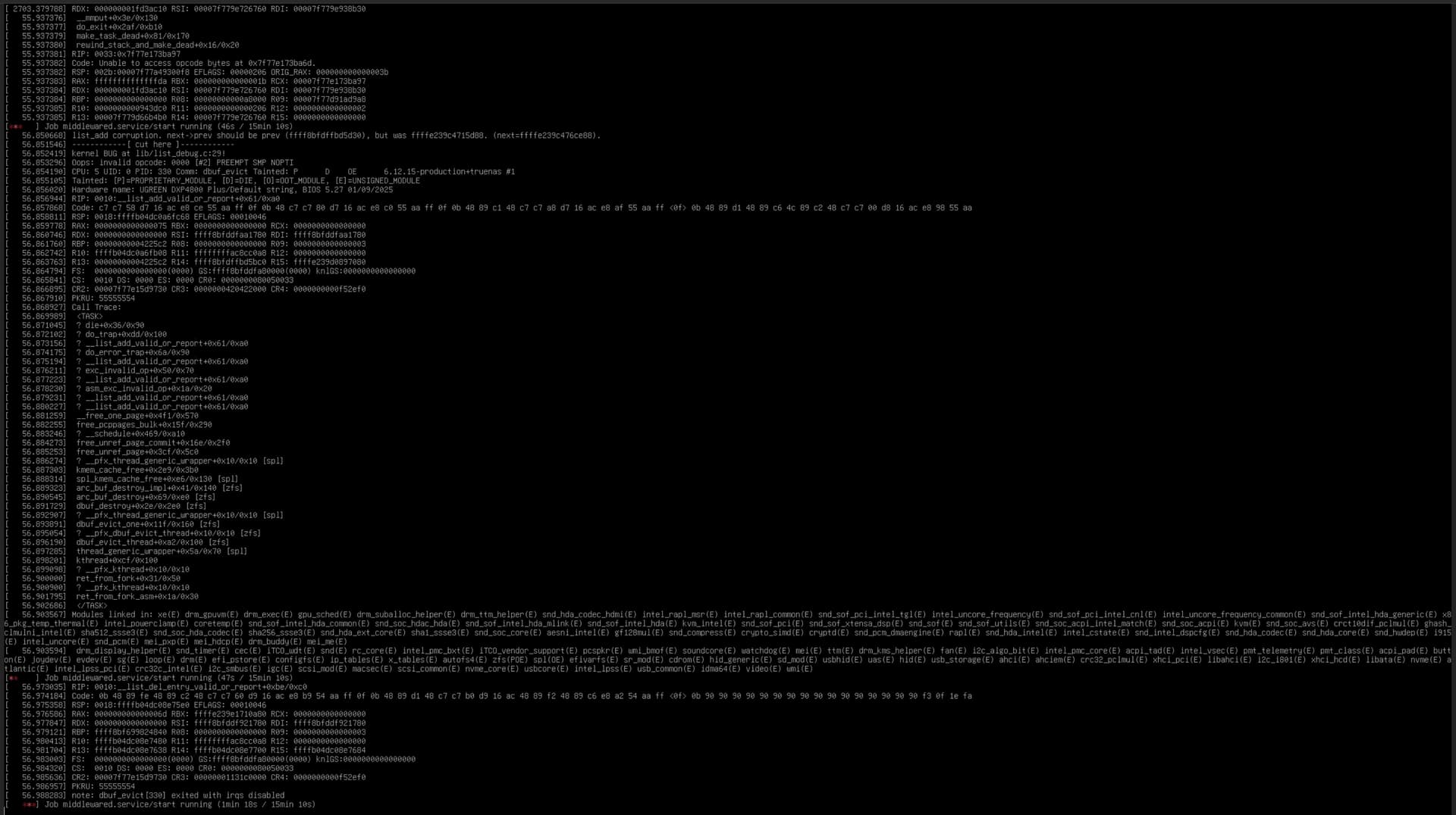

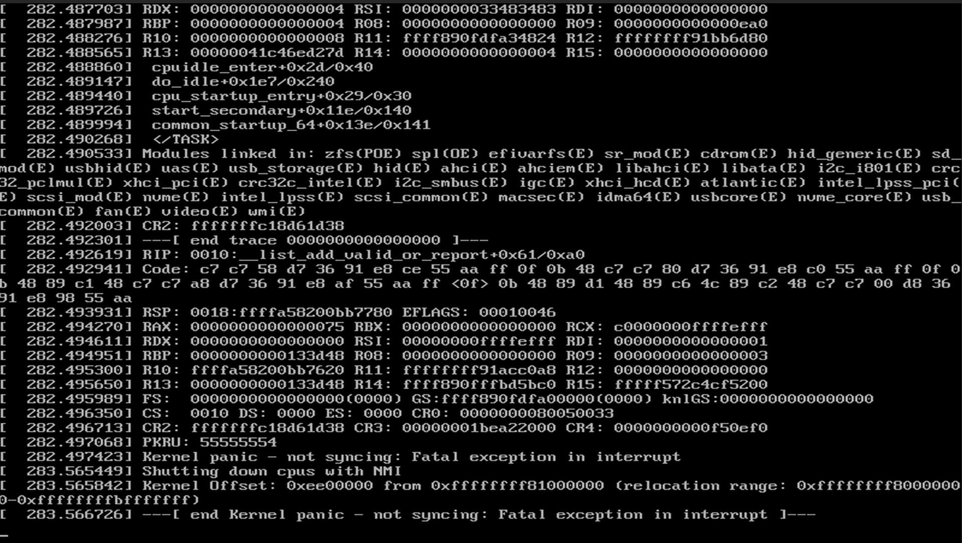

After the RAM was replaced, when crashes happen, I can see from the KVM screen some output, although only the last bits. Can anybody help me decipher what might be causing the crashes? Each screenshot below is from a different crash.

How the system Is connected to the lan, via the 10gb Atlantic nic? Because in your place the first attempt i would try Is to disable It via BIOS and try the 2.5 Intel one. The second screenshot to me seems to show a driver failure.
The general how-to-debug in those case Is tryng to run the system as minimal → check stability → add a new variable each time and check stability again, until the problem not come out. Yep, It require a lot of patience, hope someone more expert can give you better tips

It kind of looks like faulty RAM still, or an unstable CPU.

Edit to add screenshot of latest crash:

you still crashes, but everytime the error seems different (but always about a corrupted pointer).
This is kinda worrying, if a fresh install didn’t help, ram are ok… what @JohnnyM adviced sound pretty usefull to ensure before contiunue
