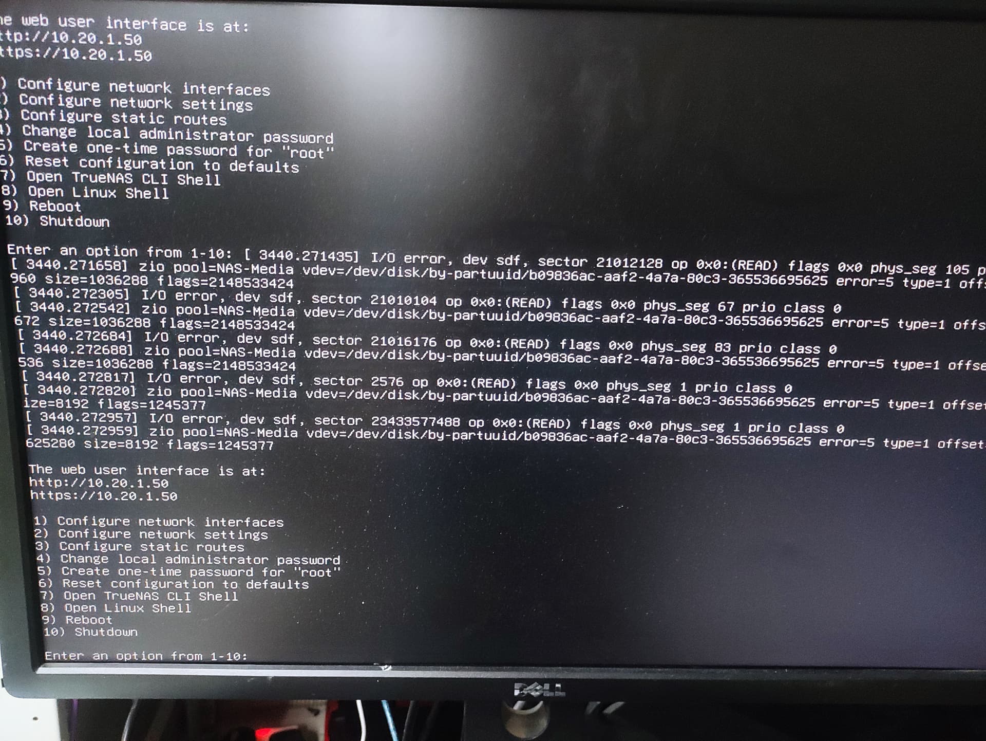

It seems that whatever I have done is causing Plex to crash the system, but as I haven’t changed any settings, everything is default from the 2nd install, I can’t work out what it is. There are no logs in TrueNas indicating an issue. All my drives pass every scan with no errors, Lastly I found that if I plug in a monitor and look at the console after it’s got stuck, I don’t see the 1-9 options, I get a whole bunch of code which I don’t understand and I can’t scroll up or down to investigate. It’s like it’s stuck. I have attached an image of it.

Ok, was copying files back to the new NAS when the pool suddenly became unhealthy. Managed to capture this on the monitor, I think my SDF drive has a problem. Just need to work out which one it is now…
